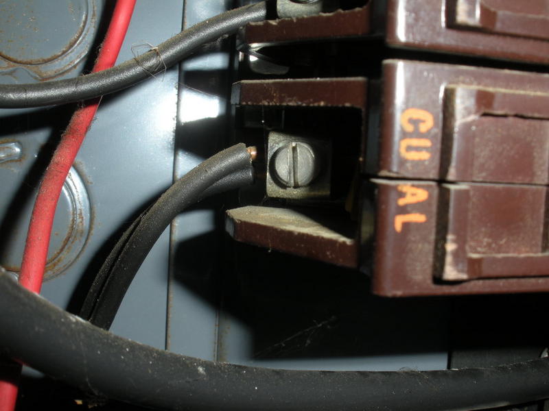

Inspected a Wadsworth panel and found a double taped breaker. This is the first Wadsworth panel for me (hopefully the last), is it OK to double tap these breakers.
No. The breakers aren’t listed for two conductors. . .
Thanks Jeff for the quick response. I did a search but came up empty on Wadsworth panels as far as double tapping is concerned.
