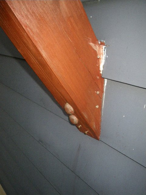

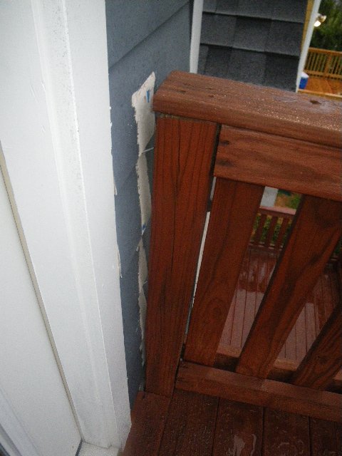

What do you think? Note the deflection in the right side support and the structure sagging and pulling away from the wall. It’s new. (Supposedly got a code inspection.) Should there at least be a sign saying, “No fat chicks”?

I see no cantilever in that picture Joe…
Wrong terminology. Changed it. Thanks.
I would not call that cantilevered. Or at least not a proper one.
Cantilevered would be supported back inside the house via beams protruding out. Any angles would be for stability only and not vertical loading.
The angled supports are probably holding up half of that deck.
Very scary. Recommend not using until repairs are made.

that one looks like it is coming down for sure…
Holy crap Batman… that is an accident waiting to happen. :roll::shock:
Yup!!! Repairs would be…
Tear it down and re-build new balcony on appropriate number of properly founded 6"x6" wood support posts or …with temporary support may be able to insert the proper posts under it.
To get that arrangement through codes here would need an engineer’s stamp and drawing. If a code inspector OK’ed it, give him a call and test his knowledge!!

Old home, completely remodeled 2 years ago. 2 year old deck.
