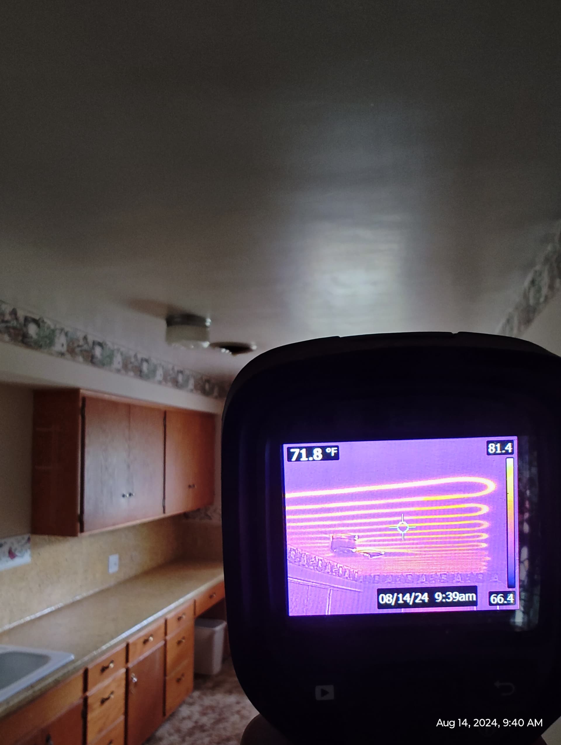

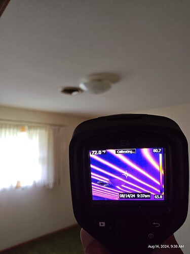

Hydronic radiant ceiling heat on a 60’s build earlier this week. Hotter than a mofo.
What were the round vents?

Three methods of heat transfer; conduction, convection, and radiation. @ruecker shows an IR image of hydronic heat in a ceiling that utilizes radiant energy to transfer heat. The system @tbakalar pictured does eventually emit radiant energy, but it takes longer to be effective. As @bhoefer noted, a series of IR images of the pictured system would demonstrate what is happening over time after the heat is initially turned on.
