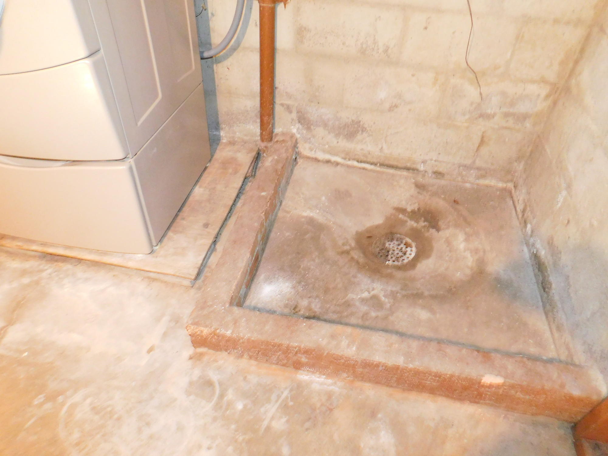

Yes you sound a little confusing to me also but typically the drain is acceptable as long as there is a air gap between the washing machine drain hose and the sewer line. Here is a pic of one we had in the basement last week it drained into a copper stand pipe and into a old shower basin
 ![DSCN2831.jpg](https://global.discourse-cdn.com/internachi/original/3X/2/f/2fbbb67a9346b487d30a9802b4767f38f8b5c084.jpeg)

It will not let me post a picture, but the washer supply box is going to be located behind the washing machine. The drain will be inside the finished wall going behind the dryer then into a wash tub. The plan is to still use a 18" standoff and go over about 4 ft. discharging into the washtub. Essentially the same concept in the above picture. Instead of going straight down it will be horizontal. Thank you guys for all your input, so much appreciated!
