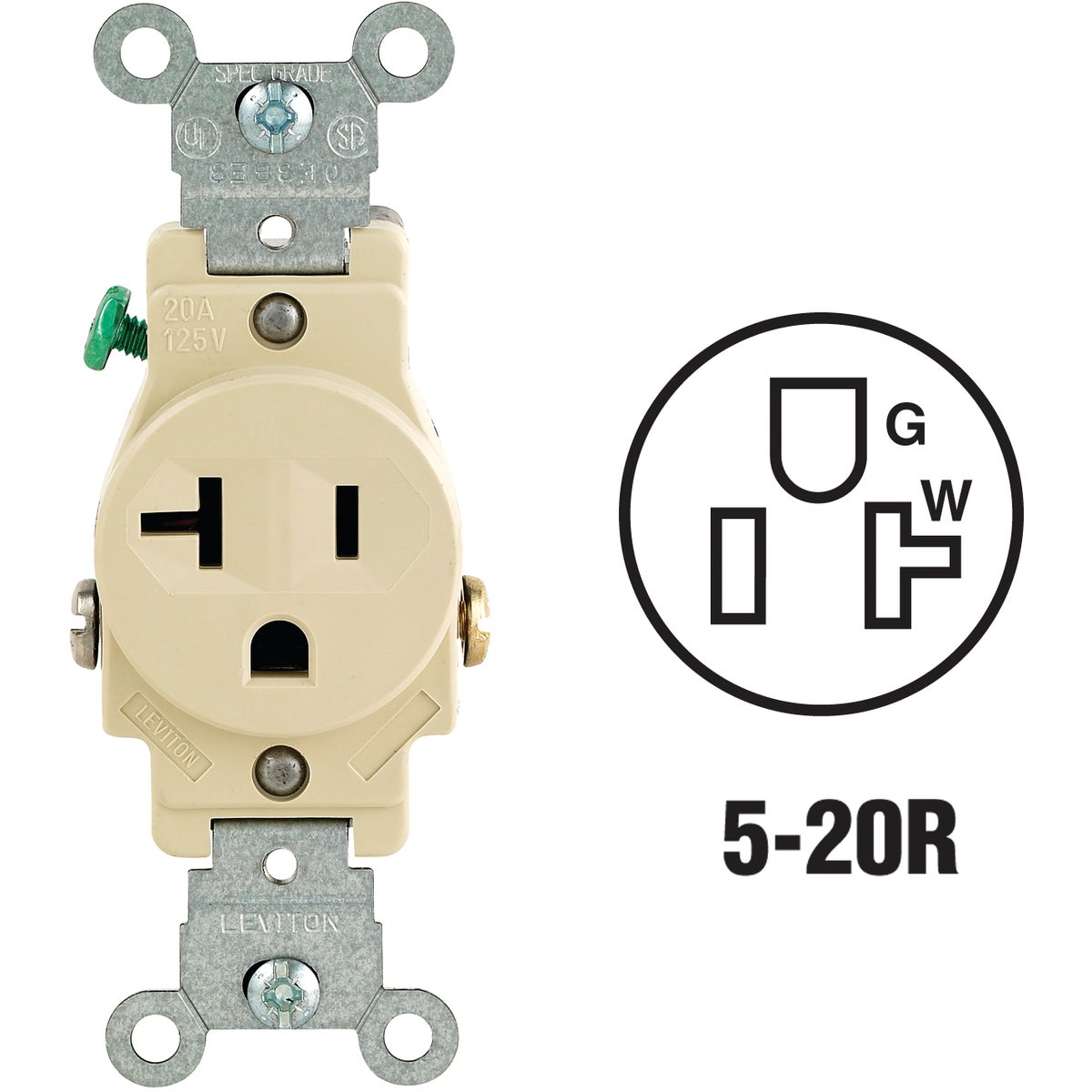

Around here, it normally should to be a [single outlet](http://media.mydoitbest.com/imagerequest.aspx?sku=509574&size=2&warehouse=C&newsize=600).

> [@jfrederick](#):
_Here_, it should be a GFCI. 🙂
