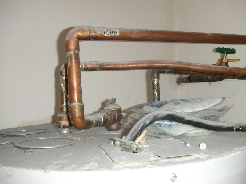

I seem to keep finding these of late
this is a high hise
multi unit
over 30 years old…
no idea where the termination is…
