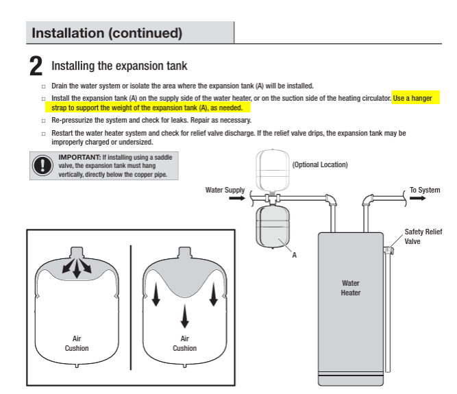

Every WH expansion tank i see is supported solely by the fitting. Doesn’t seem to be a problem. i wouldn’t call that out.
I call every expansion tank out that’s not properly supported in the event that the bladder fails and fills the tank with water. I’ve seen them bend copper pipes and even have seen the tank itself get damaged.
I rarely find one anymore that’s not properly supported.
I recently called this one out for lacking proper support.
do water heater expansion tanks need to be properly supported? - Google Search
Yes, water heater expansion tanks must be properly supported, and not solely by the connecting piping. Manufacturers typically specify this in their installation instructions. The primary reason for this is to prevent stress on the plumbing connections, which can lead to leaks or failure, especially when the tank is full of water.

Every WH here gets inspected by the local plumbing AHJ. None have additional expansion tank support. Hard sell as a defect when thw AHJ approves it.
http://media.wattswater.com/2915054.pdf
If the water piping has adequate support near the tank, and the tank is in a vertical position, then extra support may not be required, in my opinion. However, any horizontal installation should obviously have additional support added.
So, the question is, what is adequate support for the piping on a vertical tank? Well, you just have to use your own judgement. Figure 20-30 lbs of weight for a typical tank full of water.
