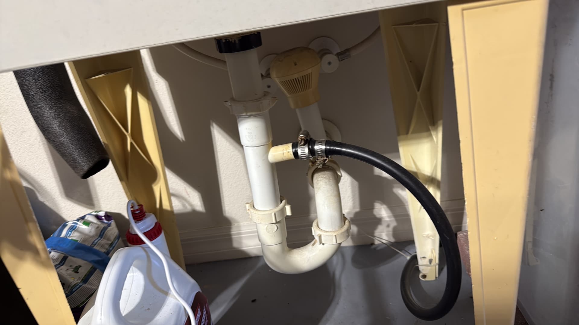

Inspecting a house today and noticed this. Water softener discharge line drains into utility sink drain line. This needs to have an air gap to prevent back siphoning/cross connections right?

My thought is if the sink clogs water can flow back into the line.

> [@dgarrett3](#):
You can connect a water softener above the garage sink.
Miss high-loop air gap.
Sorry for the edit.

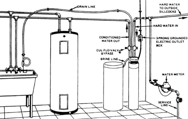

Do you have a picture of what that would look like?
<div class="post-metadata">
**Post date:** [August 25, 2025, 11:35am UTC](https://forum.nachi.org/t/water-softener-discharges-into-garage-utility-sink/259950/7 "2025-08-25T11:35:17Z")
</div>
Simple stuff, Donald.
Follow the water softener drain line to the sink. There is a complete loop or 360 degree loop in the end of the drainage tubing.
