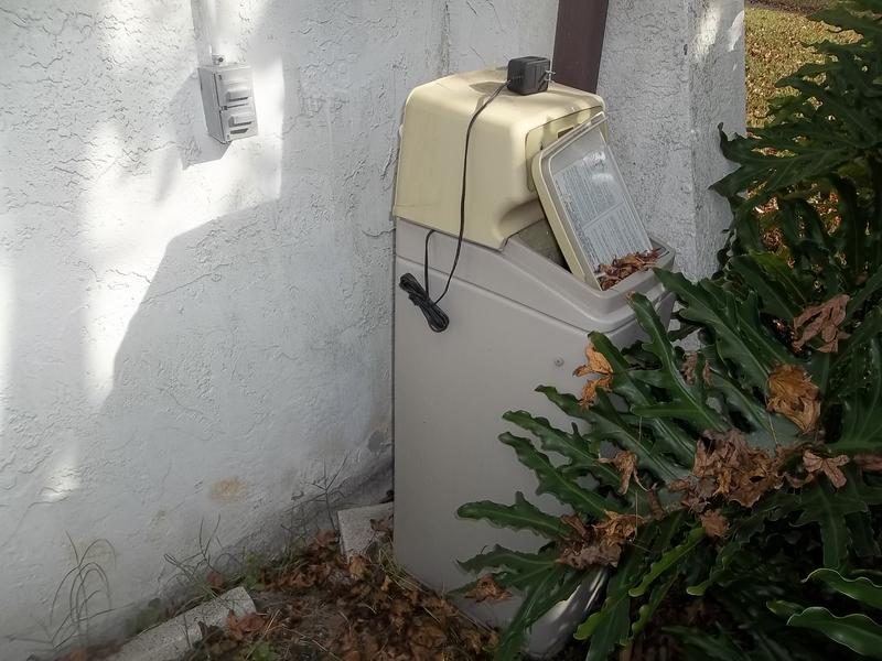

WATER SOFTENER- PURIFICATION SYSTEMS: A water softener is a device that reduces the hardness of the water. These systems typically use sodium or potassium ions to replace calcium and magnesium ions, the ions that create “hardness.” An inspection of the equipment is outside the scope of the home inspection, more information about water softener(s) can be seen at this web site: http://inspectapedia.com/plumbing/Water_Softener_Cleaning.php
Here’s one from last month draining into the sink drain line…and another from last week.
Did you comment about the improper drain connection in your report?
I had a beer with my city attorney (friend) and asked him about this.
His specialty is consumer law.
He said “if the client ASSUMES you know something about a water softener, pool, spa ect… then the inspector can absolutely be brought in on a one-two party or vicarious lawsuit.”
If he was an inspector, he would disclaim the softener in the body of the report and rec’ a certified well/softer Co. inspect it.
He also said it is cheaper for your E&O Ins Co to settle in the early stages than fight and pay legal defense fee$.
“An extra 5 minutes of typing could save you in the long run.”
" Due diligence trumps SOP"
