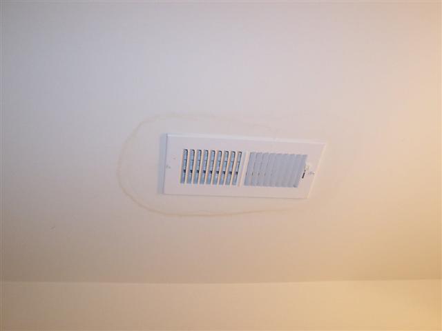

Anyone know what causes water stains on a ceiling around the HVAC vent? The A/C wasn’t running at the time of the inspection. The stain was dry. In the attic, there is no other explanation for the stain other than from the HVAC duct. The flex duct seemed tightly sealed to the vent. No other vents in the house exhibit the problem.
Don’t know if the photo shows it well, but here it its.

What kind of flex? Was the duct insulated?
May be warm attic air hitting the cold AC duct, condensing and running down to the ceiling.
Was it in a bathroom?

Yes. Very well insulated. House is 3 years old. The air getting to the duct is logical, but I didn’t see how it could have happened. Then again, I didn’t spend 30 minutes stooping down at the duct trying to figure it out.

Often this is cause by cold air escaping around the duct connection at the register. Typically you find it is being held together with just zip ties. cold air + warm moist attic air = condensation. Same thing you see around windows that leak air. Condensation on the window ledges.

“A HVAC vent in the ceiling of the upstairs hall bathroom has a water stain around it. The A/C unit was not on during the inspection and the stain was dry. From inside the attic, the only logical source for the stain is from condensation around the HVAC duct. Repair to the duct by a state licensed HVAC contractor is recommended.”

The condition is common around here. People run their air conditioners with a window or the sliding glass doors open. The warm moist air enters the home and goes upward, and condenses on the cold metal HVAC register.
The one above my recliner in my family room has “rained” on me from just that circumstance only to wake me up.😉 Yes, there is a moisture stain around the duct.

The only thing I would change with your report is ‘Recommend evaluation and repair by a licensed and insured HVAC technician’. I always leave the diagnosis to the pros. In that way, if there is some other problem or reason, I am clean.

That’s what I was thinking also…why I asked if it was a bathroom.
Showering, moist air up into the cold duct and water down to the edges and into the drywall.
