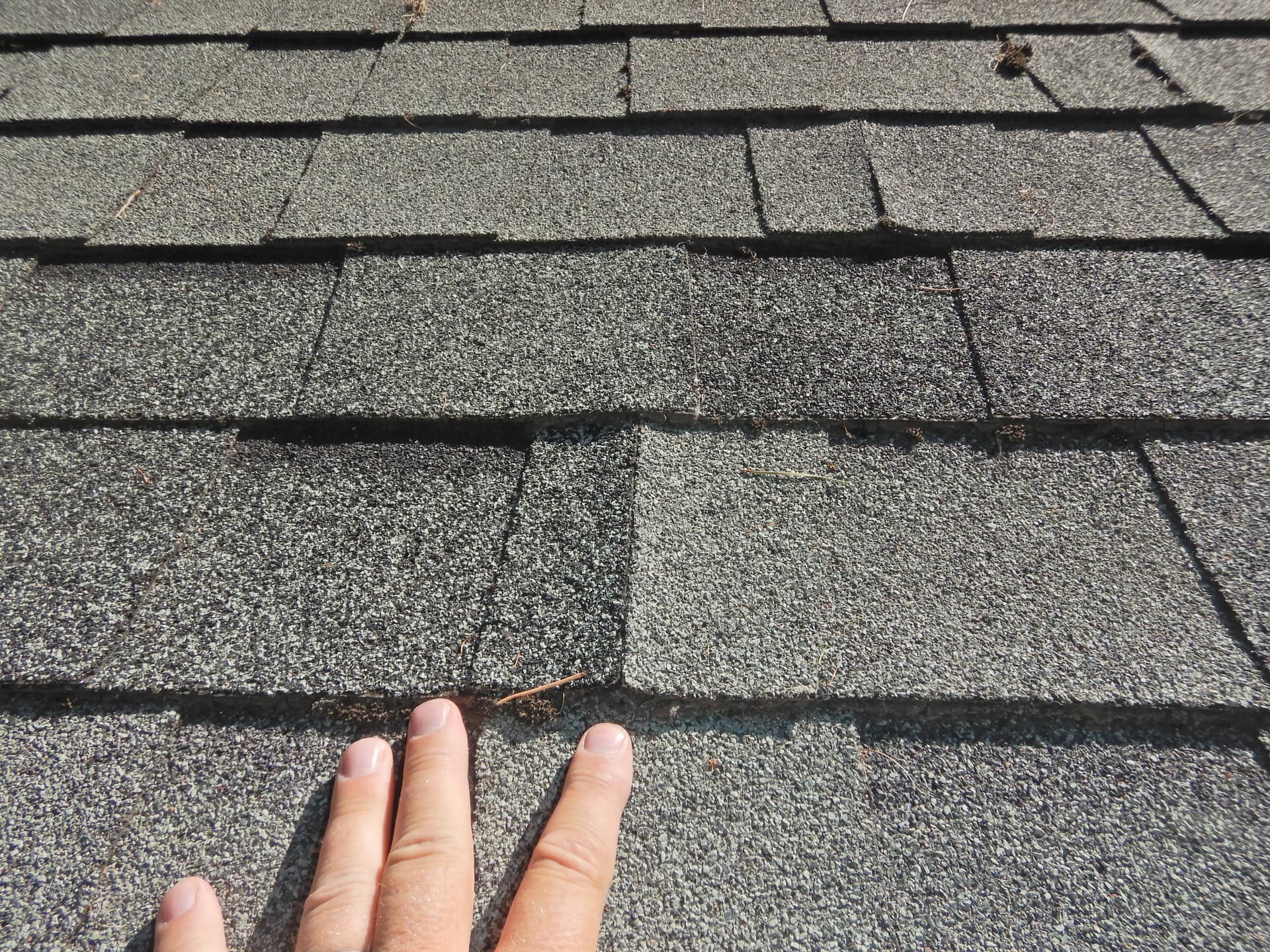

The roof is 20-25 years old with one layer, vented by soffit/ridge. The waviest looking side is Southern exposed. My question is why or what is cause the shingle to have a wavy look with some buckling. If the underlayment roofing paper got wet before installation could that be cause?
 ![DSCN0036](https://global.discourse-cdn.com/internachi/original/4X/2/f/f/2ff5ad3cc91c58b46f581e37fb44d7b36c24c9e7.jpeg)
 ![DSCN0037](https://global.discourse-cdn.com/internachi/original/4X/4/2/b/42bc24633ff2062b5b617f0b9f8e8a4f852f5285.jpeg)
 ![DSCN0039](https://global.discourse-cdn.com/internachi/original/4X/1/b/4/1b43a7644421d4fe3aebe80eca361cc7d1b83d15.jpeg)
 ![DSCN0042](https://global.discourse-cdn.com/internachi/original/4X/4/f/8/4f8e8d1fbb59fc6a2689e7471768d1bfd7e19676.jpeg)
 ![DSCN0043](https://global.discourse-cdn.com/internachi/original/4X/5/9/2/59239de823a0f077ac64ab53696d7e20863cceab.jpeg)

As a home inspector, just write up what you see and recommend further evaluation by a roofer. It may be underlayment, but that pattern is different than I typically see with thermal expansion of the underlayment.

My opinion, it looks like the shingles were butted too tight. There should be a nominal gap for expansion.
That said, it’s not the only explanation. As @lhenderson2 and @badair stated, don’t box yourself in.

Morning, Shay. Hope this post finds you well.
Observations: Composition shingles.
Wavy, lifted shingles.
Installation deficiency.
Suspect: [Fish mouthing](https://www.alpharoofingtexas.com/faq/residential-roofing-curling-shingles/#:~:text=Causes%20of%20Fishmouthing&text=When%20the%20moisture%20tries%20to,the%20edges%20of%20shingles%20meet.). \*Note: Fish mouthing occurs when the moisture tries to escape through the decking, it can reach the underside of the shingles, which is the least waterproof part of an asphalt shingle. **The moisture and exposure to the weather** can cause fishmouthing, particularly at points where the edges of shingles meet.
Recommendation: Recommend a licensed roofing contractor service the roof within 1 physical year or prior the onset of winter, whichever comes first.
Act upon referrals offered.
Limitation: Inspected from the roof.
Good linked article on fishmouthing. Covers new and old shingle roof coverings.
