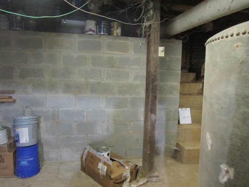

great idea and excellent advice. just in time too. i have an inspection today that the homeowner said had a basement added tot he single story brick house years ago. i was not aware you could just add a basement, at least not easily, so this should be interesting. and this comment was right on time for it. thanx.
That will be interesting. In my area, I have seen dugout basements derived from a crawlspace. They are typically much smaller than the footprint of the home. Watch out for the soil excavation around the footings, they love to cut it close ![]()
Get yourself some basic understanding of the “Angle of Repose”.
You would be surprised how often this knowledge comes in handy.

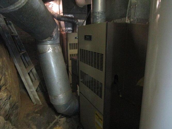

Here is a 100 year old home. Once used for coal, boiler etc. the basement footprint was expanded slightly, shoring added. It is cool to see the old shoring and the new shoring and where additional shoring is needed in one location because the soil was migrating down. Time for an engineer.
New shoring
This wall to the left was not performing well
Performing well here
yeah, after seeing it i realized i’ve seen it before. it was well done i guess, finished at least, but damn there were some issues. it looked like the cracks had stopped but who knows. the built a room addition on a deck. it was not going well and the sliding door didn’t open or close completely even had the feed wire to the electrical panel just hanging on the side of the wall in the crawlspace. yeah, glad i talked to the client’s dad at the end. he knew about some of the issues and i told him that it wasn’t that bad of a house, just as long as he knew what he was getting into. i’ve seen some of the hack jobs they do in wv and not all of them are bad or unsafe, but you never can tell with some until it’s too late. it will make a decent first home for his son he thinks.
