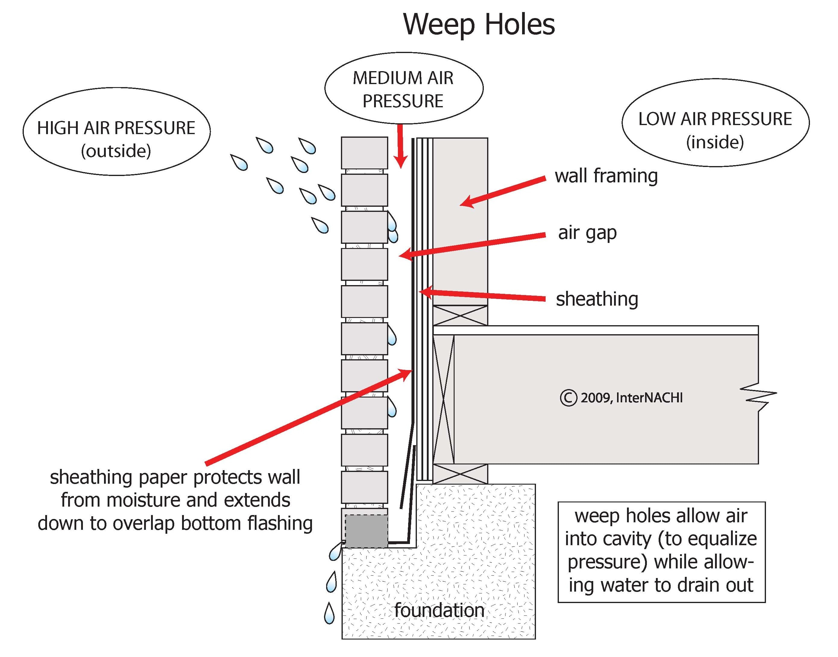

Weep holes located below the window ledge. I've never seem them like this, they aren't
there isn’t supposed to be weep holes below the window ledge right? My interpretation of the the code is bottom row of bricks Anna above windows and doors. Is this a defect?
Answer this… What harm do they do?
None really but in some cases I’ve seen 5-6 bricks down from the window ledge.

And answer this… What purpose do they serve?
Flashing and Weep holes
In general, when a collar joint, cavity or air space is interrupted, such as at sills, at the base of the walls, at lintels over openings and at shelf angle supports, flashing should be provided in the wall. The function of flashing is to serve as a collector for any moisture penetrating the wall or the sill.
Once moisture penetrating the wall or sill has been collected on the flashing, it must be removed from the wall. This is the function of weep holes.
Brick sills have potential avenues for water penetration.
So the detail shown in the OP’s picture is actually lacking showing the extension of the flashing beyond the brick face and drip down.
They do a lot of harm, if not installed correctly.
Back during the Great Nashville Flood I had a dozen houses that were damaged by weep holes. But 19" of rain tends to do that…
The mortar joints of the ledge should not line up with the weep holes or water will flow right in.
If the window unit leaks, it allows water to drain and air to ventilate.
To ventilate properly there must be an opening above and below. The window unit blocks the opening at the top of the wall and stops ventilation of the finger space.
This is not based on building code (which is not our job), rather Building Science and Thermography which documents these findings on a regular basis.
