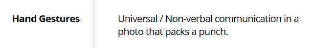

Nick, I know you posted it here for us to vet. Here is some feedback.
I found this casual approach to be too informal and patronizing.
 ![image](https://global.discourse-cdn.com/internachi/original/4X/c/c/6/cc6072628f440df5d3ce21d20e93d915c41fb7b9.png)
see above
 ![image](https://global.discourse-cdn.com/internachi/original/4X/e/3/6/e36e5560acd03f7715abc7823001ac22fb36f7b0.png)
I am just curious if this can be removed; we were instructed to ignore it in the video.

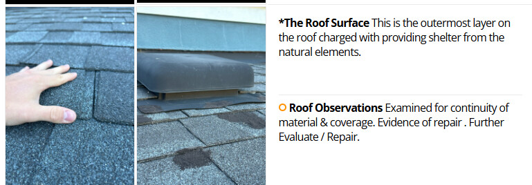

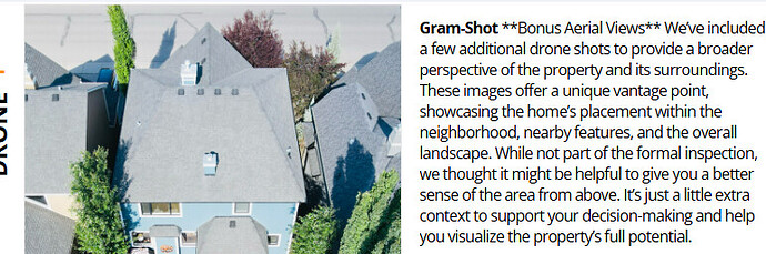

More fluff. Are we listing the home for sale or inspecting the home?
 ![image](https://global.discourse-cdn.com/internachi/original/4X/e/a/5/ea59fa807a3c9486ca0416dbd5193a8afb6352b7.jpeg)
No way I could publish this and expect to be taken seriously.

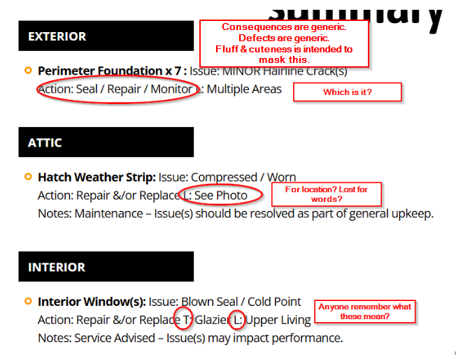

Ultimately, I understand that much of this is style over substance. But this style is obviously promoted. Promoted alongside shorthand and as many abbreviations as possible.
And I agree with @bhull1 that this report and the SoP need to be scrutinized further.
This developer has not produced a coherent and complete sample report. The report style is casual, the report is not detail oriented, and much of the information is abbreviated, ambiguous or wrong. Am I to expect the same from the developer?
Is the client to expect the same from us?

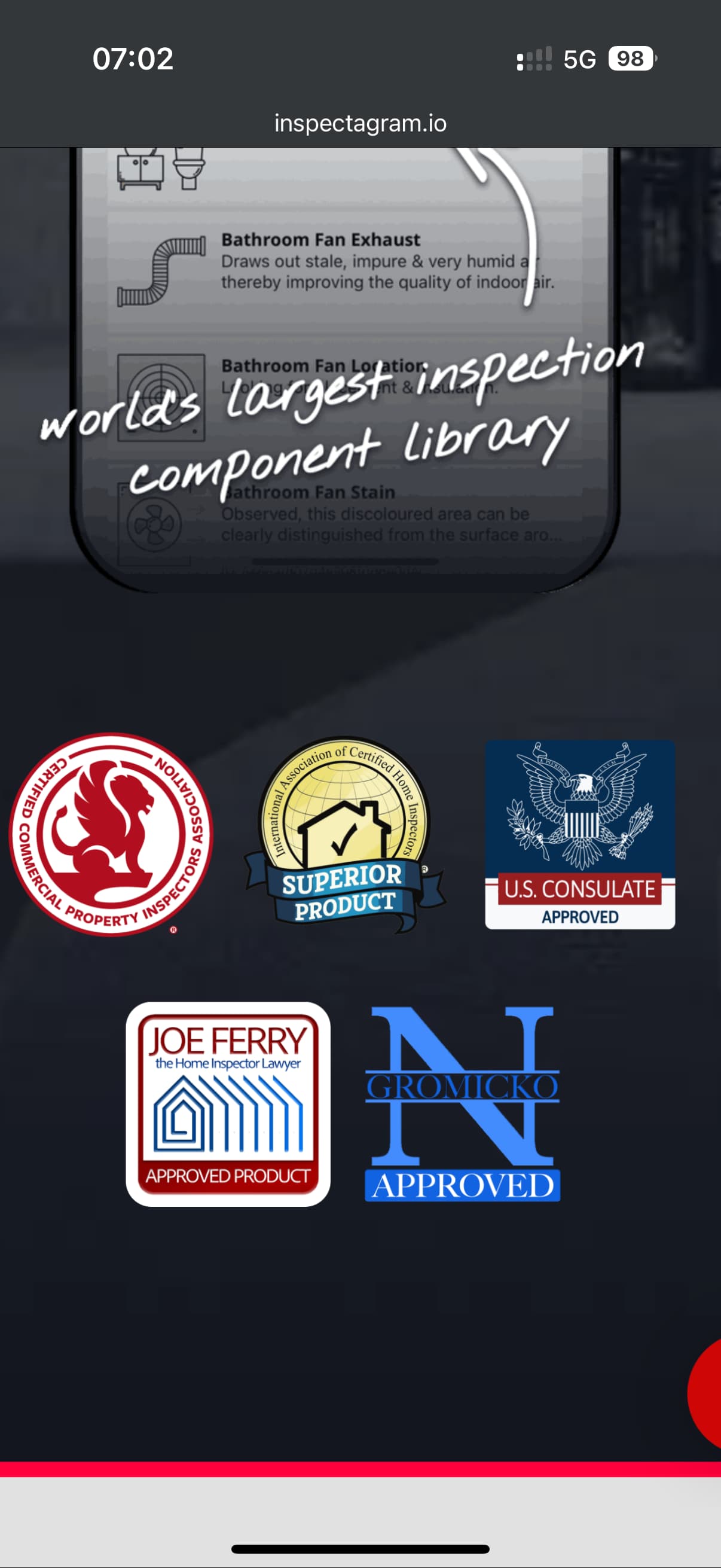

> [@bcawhern1](#):
+2 on that. They state on their website that Joe Ferry endorses Inspectagram and is also US Consulate approved (I don’t understand why this is important 🤷‍♂️). I would love to see the report(s) that they were given to vet this software.
 ![IMG_7318](https://global.discourse-cdn.com/internachi/original/4X/3/7/d/37d15cec33764e34fec913cb389bc6c980ac3a23.jpeg)
 ![IMG_7317](https://global.discourse-cdn.com/internachi/original/4X/f/f/9/ff92d1e3f645877e66e55747864b84c81ac85b62.jpeg)

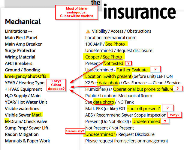

> [@lkirsch3](#):
> I’ll drop a few reports here….
Thanks. So just looking at the link, if I’m a client, and I read the below item, what should I do?
 ![image](https://global.discourse-cdn.com/internachi/original/4X/2/7/3/2730129666dc0af89c9b9febe378956f4361bf79.jpeg)
