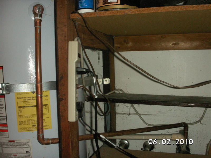

WH drain in washer stand pipe
Not the smartest install, as one can never see when the T&P valve begins to weep but is it ok to install this way?
Needs to discharge via a visible air gap. So you pretty much called it. Can’t see the discharge…

In San Diego it is allowable to have a T&P line discharge into a laundry drain. I see it all the time. What you see there is ok

What is “allowed” by an AHJ, should be irrelevant to a calling out a condition that is potentially fatal to a client.Maybe they do allow it to discharge into a drain as long as it didn’t violate any other safety concerns… Here are the vitals of what you need in regards to a TPR discharge…

Reading post 5 - #9 would be an issue as well since the pipe extended into the standpipe a short distance.
Yep, that goes along with #14 IMO.
I hope that power strip was called out also.
Am I missing something obvious? What’s wrong with using a power strip?
Looks to me that it is being used as a permanent conductor.
(not allowed)
Not happy with a few other situations either.
Ditto what Chuck said.
What is wrong with San Diego that they would allow it.?
I would not even mention it out of civic pride if I lived there.
What may or may not be “allowed” by someone has no bearing on what I write in my home inspection report.
I cannot report on what I cannot see…and if I am forced to assume, I will assume gray water backflow when I cannot see an air gap.

Sounds great but remember this is federal code and can be superceded by local codes and/ or ordinances. No plastic piping in Chicago for connections on Tpv. Hot water will melt those lines like you would not believe.
Then why is CPVC allowed as a T&P connection line? The max water temp would only be 210 F??
Chuck
“codes” and what is “allowed” are irrelevant in regards to if we call something out or not.
In regards to plastic: CPVC, polyethylene, polybutylene, polypropylene are all rated for this purpose because they don’t melt. PVC is only rated for 150 degrees, so that would be what you would want to look out for in that regard. (I’ve also seen a garden hose directly connected to the TPR.:roll:) If they aren’t “allowed” in your jurisdiction, then it would be appropriate to say so, but I would also mention that it is a local ordinance, and not necessarily required for repair during a real estate transaction (at least not where I am).
