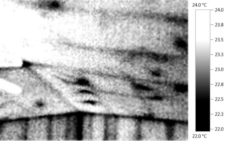

what am I seeing?
I have seen this twice now, coarsely chopped fiberglass and random cold spots on the ceiling (cathedral ceiling with scissors trusses, 12 inches insulation depth no access)
I think cold air is moving down through loosely packed insulation and getting to the ceiling, but a colleague disagrees, and says insulation has settled and is compressed at the cold spots.
Any other opinions?
I agree with Eric no way can insulation even if there is some compression at the bottom the balance would still do a fare job.
Adding some cellulose blown in might help to fill the air gaps in the existing insulation.
Another idea is a small fan constantly running might stop the cold spots from forming .
Could be air pockets due to the course insulation or rodents but I don’t see any trails in the photo.
What brand/model camera is this taken with?..

Has there been any mudding /drywall repairs done recently?
My thoughts exactly, that’s bad…
Your asking questions about a image that does not appear to have been thermally tuned and almost impossible to tell what is going on with your image. It would just be a WAG
Testo 875-1
Teach me for getting fancy with the software, like these better? Outdoor temp was pretty warm that day, if it was colder the blobs would have better definition.
Then that would lead us to hypothesize that it could be air?
When I am in the software I tweek the yellows a bit darker and the blues a little softer. Its just a fine line to provide a sharper image especially on your bottom image. Every thing is adjustable except the focus
In the three images all I see is a little air migration and some thermal bridging at the end of the studs. Seen it a million times nothing to write home about.

Is that the 875-1 or the 875-1i
9 Hz or 33Hz?
Agreed.
Not enough temperature differance for water.
The entire span of your image is 2C°. The difference that you are seeing is about 1C°. If I had to hazard a guess based on the color renderings, I would suspect that the insulation is not making full contact with the air barrier (sheetrock). Possibly, mouse burrows, looks like there are trails on the top side…
I personally would not consider such a small anomaly to be report worthy in a home inspection, but that’s just me. I wonder what the ROI break even point would be for attempting to “correct” it?
You would want to have a known minimal temperature differential across the thermal envelope and time enough to reach equilibrium.
I have no idea why screen refresh rate would be considered a relevant question to assess a still image???

The heat transfer rate is a multiplier of the temp differential. Less than 2 degrees as well as the small area ratio is insignificant.
Conduction losses are also much less of an issue compared to convective loss (and even radiation transfer), but conduction loss is all that is talked about (insulation and windows)…
I wouldn’t try to fix that even if it were my own home.
Thanks all, as I said I have only seen these blobbies a few times, first time was a client who asked me to check his house because there were cold rooms, this last the client also complained about the heat until they added a pellet stove. I was there because they had a problem. 99% of the time I see the same as in Charlie’s example, the joists or trusses. I have also seen obvious cold areas and found that was where insulation was missing in the attic. Here are some more, from April, outside temp was -9 C or about 15 F, cold rooms in house, I was able to enter the attic, and could not see any missing insulation.
In your first and third images you can see where the truss supports enter the insulation and then compare the thermal to the digital and you can see where the temp follows the brace into the insulation. The whispy areas in the insulation are simply temp intrusion thru the insulation. Needed more insulation
