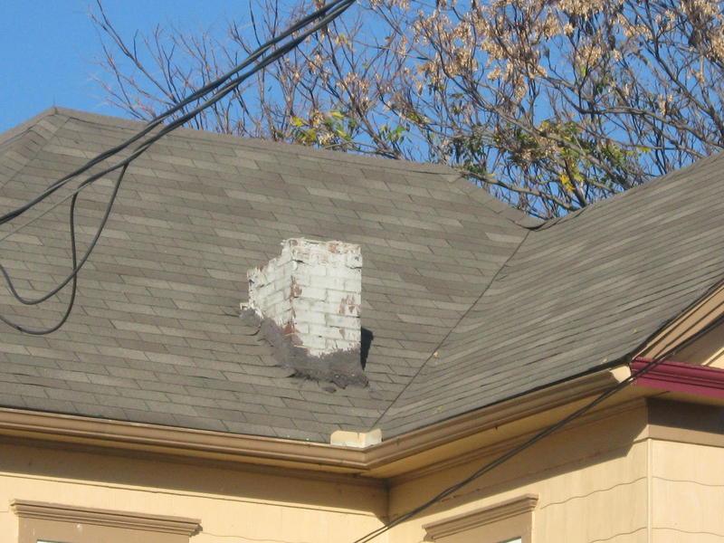

Both these buildings are Commercial. The one on the right is a duplex; the one on the left is a 8-plex. Although rehabbed both are 100-110 years old.
Looking at photo #1 - The brick building seen at the rear between these 2 buildings is a battery manufacturer. Looking at photo #2 - The white block building about 9’ to the side of the duplex is an old gas station and tire store. Think Phase 1 AND wonder if that had anything to do with why the owner was financing it himself.
Looking at photo #2 - You see the overhead electrical line coming from the pole to the duplex. Someone has added a rather large 2nd floor deck to the duplex and the meter is on the side of the duplex at the base of the deck. IF the overhead wire was run straight it would go across the center of the deck at a height of about 4’-5’ above the deck floor.
THEREFORE they have ingeniously wrapped the overhead power lines around the large tree trunk / anchored them to the white block walls of the gas station / then run them on to the duplex wall and down to the meter.
