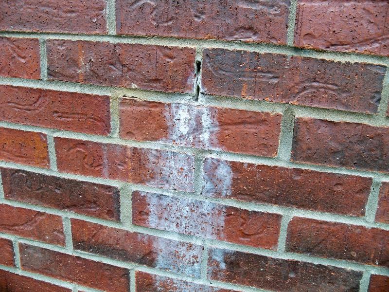

What caused these stains ?
What caused this to develop under each weep hole on the exterior of the brick veener wall? I did not see where water could intrude anywhere above this area, it is on the gable end of the house.
How would you document it in a report. Thanks
Those appear to be weep holes
They are weep holes. Is this normal to have this much moisture / staining coming out of the weep holes ? should I write it up ?
It appears the stains are lime from water draining at the weep holes.
The water/lime could be a result of someone washing off the bricks.
There does not have to be a specific point for water to “intrude”. Bricks are not water proof, they do absorb moisture.
