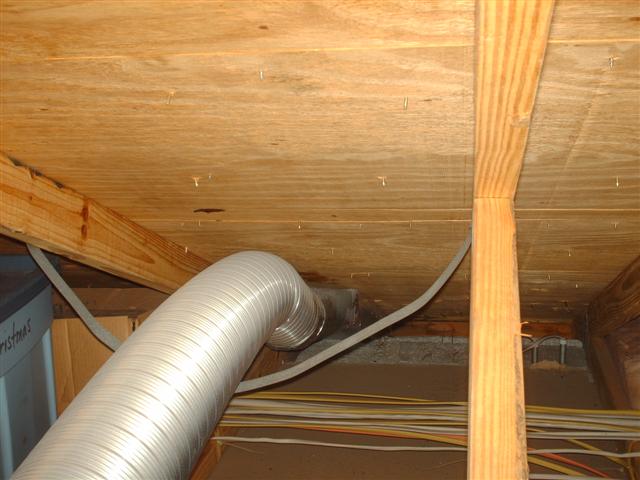

What is going on here?
This was in a home built in 2003 in Lake Worth, Fl.
It is a fresh air intake from the exterior into the intake line which is in the garage.
Seems like a make shift Radon mitigation system.
Could it be for a HRV(Heat recovery ventilator) or ERV (energy recovery ventilator)?
Is this a Cat 4 furnace and do you have any pics showing the other end?
We don’t have Cat 4 furnaces here in S Florida…hell 1/2 the houses don’t have ANY type of heat.
Well he did say air intake and this is the HVAC section.
Maybe he meant makeup air to closet.
It is an electric, 3 ton split system air conditioning unit.
The line is, as you can see, metal and not insulated. The box, which is above the soffit, goes to a vent outside.
The homeowner stated that this was a new requirement when the home was built.
It is for make-up air that runs through the attic, down through the garage ceiling , and into the return plenum, which attaches to the stand the air handler sits on and then goes through the ceiling and connects with the other return registers in the bedrooms. There is also a damper right where the line connects to the plenum.
I am assuming that the box pictured is some type of filter so that unwanted odors do not enter the home.
I couldn’t tell if condensation was building up which caused the sheathing to rot, or if it was from a roof leak.
If the hot air from the outside can get in, what is to prevent the cold air from the home to get out?
I doubt very seriously that the local AHJ requires outside make up air but on the other hand anything is possible.
Don’t assume anything the box pictured probably has no filter just a square transition from the round duct to allow a square grill in the soffit.

I am posting this because it is something I haven’t seen in 22 years of performing inspections.
Trust me, I am well aware of how the system works.
I am also well aware of the code requirement for insulation (R-4.2) in an enclosed attached garage, which is where this line is located. I sent that along with another code reference
Which would imply, that there is a possibility that make up air from the exterior is allowed.

As to make up air of course it is allowed from the exterior of the home just restricted as to where it can be taken from. Normally not required as 10% of make up air into a home is obtained through doors and windows
I’ll enlighten you as to the last question. Here , on new construction, it is required that there is an intake in each room for make up air in addition to the main intake. This is tied into a box in the attic, in this case, in the middle of the hallway. This is also the filter location. There is a 16 inch line that runs to another box in the garage, which extends through the garage ceiling.
The fresh air intake line goes from this box, in the garage, through the garage ceiling, and this is the line that exits the building through the box shown.

Correct me if I misread something but it appears the original post is all about a portion of the return air being drawn in from the exterior.
This is typical on energy star homes or homes built with attempted energy saving methods. Research is being done to change the standards since the big savings are not being achieved so far.

If that chunk of metal pipe you showed us from the attic enters into the garage, I’d be more concerned about it not being fire rated!

you’re the one that knows exactly what’s going on! It doesn’t matter how big of a hole you have in the side of your house if there is not a difference in pressure between the inside and the outside the air will not flow. need I remind you of this?
It appears that you’re making some sort of assumption without any documented testing results. What is the pressure differential of the building? Where is the neutral plane within the building?
With this type of system installed it will generally create positive pressure in the building (in most circumstances). What is the pressure of the building? Or did you actually evaluate that?
You ask us to evaluate which you have not evaluated. We cannot give you a definitive answer unless you provide the necessary data.
I won’t bother with most of your response. What I will say is that I took my ladder, climbed on it and put my hand next to the exterior vent while the system was off.
Guess what I felt? Air coming out of the vent.
Do you have any plausible explanation for this?
