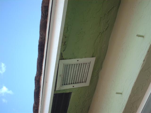

So using your logic, it doesn’t matter how much air is exiting the home from the a/c system?

Here is the vent in question:
I am telling you I have seen this EXACT installation for Radon Mitigation system. Its looks like an after market install and not an install when the house was built. Is there a fan anywhere or is it just passive?
The owner stated that it was built with the home, and a requirement. We shall see. It is passive. A direct intake to the home.

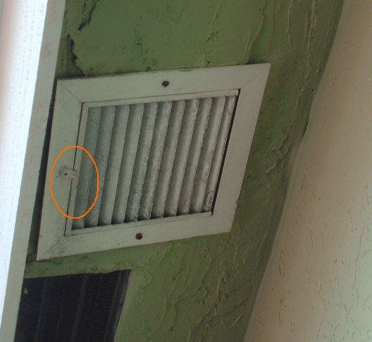

To the person who poo-pooed the filter question, see the attached photo, specifically, the circled portion…

**If the hot air from the outside can get in, what is to prevent the cold air from the home to get out? **
Dave likes to use theory I try just plain old common sense. That statement you made makes absolutely no sense you did not say there was air coming out of the soffit vent you asked what would prevent it.
Air does not move by itself If you would use your head and think about it pretty simple. There has to be a blower to move it or a temp differential to make it move. Hot air rises cold air sinks what you have describe the only opening into the system is the interior return air grills and you are saying that the colder air from within the home is going to rise and travel through the hot duct in the garage to the exterior of the home I don’t think so
What you are saying makes more sense than anything but the gent stated the duct was connected to the return on the central system which would eliminate radon In this State PVC pipe is required for Radon mitigation discharge

I used my head and the question still remains, why was air coming out of the home? I didn’t hear any fan and even if I did, why would you want the air that was cooled coming out of the home?

That study says that he air handler cannot be in the garage, which is where this one is. Not to mention that the intake line isn’t supposed to be installed where it may come in contact with exhaust fumes. There is an ally that runs near the home.

I saw a small fan box on a return hose that was setup like that where it was pulling in outside air on a new home (energy star).
I did not check to see which way the fan was setup (2 story vent).
Maybe your house had a fan assist somewhere on that duct and was installed backwards. Or maybe someone wanted to discharge air when the system was off and pull in outside air when the system was running. This could be done with simple control voltage.
You don’t want condescending remarks but the information you provided makes no sense defies the laws of nature cool air does not rise. I can tell you this after 40 years of working in that profession I to this very day still see things that mystify me but what separates me from you is I do not leave the job site with questions unanswered I investigate until there is a logical reason for what I am seeing.

Back to your question why is there air being discharged from the duct when the unit is off if indeed it is I don’t have a clue but I can tell you this I would know the answer before I left the job site
The head code official called me this morning, yes, on a Sunday. He stated that this installation was a one year only, city specific code. It was changed the following year to be effective for commercial installations only. He also suggested that my Client remove the fresh air intake.
I will speak with him tomorrow to find out the reasoning, but I have a feeling that some of what I posted above would be those reasons.
