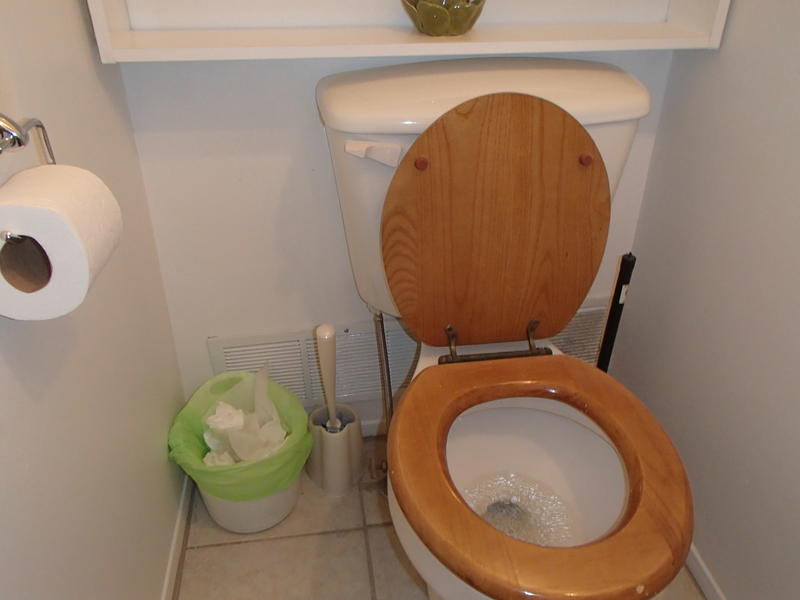

What is that smell?
Honey, where is that smell coming from?

This was residential and a return to the ventilation of the home…thus my comment: Honey, where is that smell coming from…
When I see returns in bathroom I like to use this comment I got from Barry A.
“Please be advised that the return air location at ***** bath may intermittently affect the aroma of the air quality at other locations within this structure. Return air should not be taken from bathroom, kitchen, closet, garage, or furnace room. Recommend to consult with a qualified HVAC specialist about relocating this return grill outside of the bathroom and sealing the original grill location.”*
Yes Marcel I completely understand that this could only apply to proper design. Info is provided to educate that this may be something we will see in residential soon and to not assume it is attached to the return of the furnace. Varify it by air flow during the operation of the furnace fan.
Varify that it is not attached to any HRV also.
