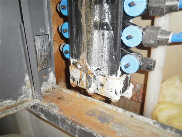

What is this called
Don’t come across to many of these, need help, not sure what it’s called.
Thanks in advance for your help
PB Manabloc
Dale many thanks!
I agree - it’s a Manabloc, but it doesn’t look like PB to me it looks like PEX.
Call it a “Water Distribution Manifold” and be done with it.
move on? what about signs of possible leaks ? corrosion?
