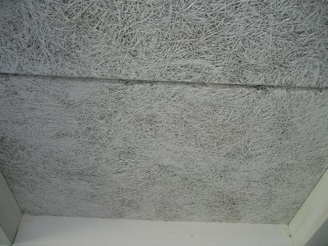

Ran across this in a home today and wondering what it is. Can anyone help? Thanks
Looks like the panels from an evaporative cooler. As I recall the material was called excelsior ?sp.
They were bathed with water and a fan blows across cooling and humidifying at the same time. Great for low humidity hot climates.
When dry highly ignitable by bottle rockets, as I recall.
These panels are installed on the ceiling of a room addition and also on the ceiling of a patio overhang. I’ve seen this stuff before but its been awhile.
It’s called Tectum, and is a porous wood fiber and plaster roof decking/insulation material. It insulates poorly by today’s standards, and turns to mush if it gets wet.

Could it be sound proofing panels without the outside covering/fabric?
Like you would find in a recording/radio studio.

Jim is correct, I use to install this as a decking material on schools back in the 70’s. I use to call it shredded wheat, because if you got it wet, it would look and become just like it.
It was a very poor material, due the protection required after it’s installation.
Whatever was installed that day had to be covered the same day. Haven’t seen it in years.
It had a very high STC rating and a lot of it was used for that reason in autitoriums, shcools, concert halls, etc.

CORRECT I used this material in the late 70s early 80s.
Peter
I actually used this in a TV studio, for soundproofing.
