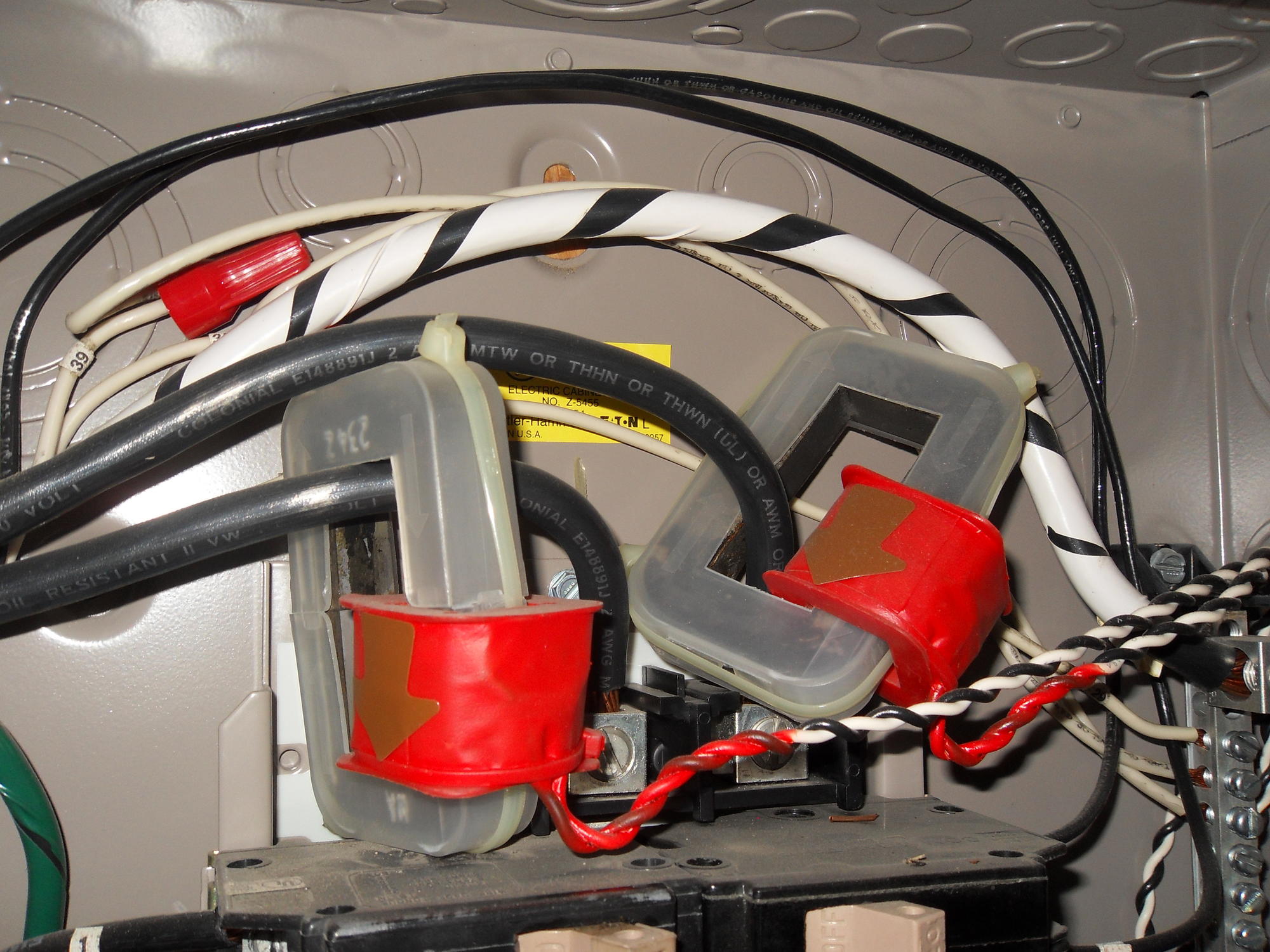

Found this at an inspection today. It was hired to a device that seemed to imply that it monitored the panel for efficiency. Anyone familiar with these? Installed properly?

Current transformers probably attached to a meter.
Part of an energy management system. They measure how much each leg of the panel is using.
