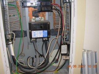

What is this?
Can someone tell me what this is and what its function is.
Thank you in advance.
Surge Suppressor
Thank you.

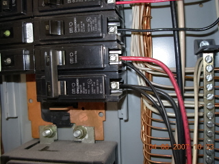

If it’s a surge suppressor why does it look like it is meant to be monted in a recpectacle box?
In any case it is not supposed to be in the panel or unsecured and not doulble tapped in the manner it is.
The TVSS is not installed in a compliant manner. A lightning strike may, and probably will, whip it about in the panel. The metal pieces on it may come in contract with the energized buss during such an event.
There’s also a white 4-1/8" round flush metallic box blank used non-compliantly as a reducing washer.
Marc, it is the following for a control system.
http://www.aartech.ca/product_info.php/products_id/68/6299.html
Leviton X10 Signal Bridge
[Leviton 6299]
Thanks…Always the best information on this message board.

As soon as I saw the pic I knew what it was. As I scrolled down I see other did as well. It IS a signal bridge.
That one IS designed to go in a wall box. I have seen them that they recommend simply laying it in the panel.
Signal bridge? Cool… learned something. Don’t do X-10, and seldom run into it. The X-10 geeks are generally DIY types, so they don’t oft call for an electrician.
The comment on the non-compliant reducing washer stands.
I’m troubled by someone who gives such voluminous and verbose electrical advice that wouldn’t recognize an X-10 Signal Bridge when presented with one. That’s pretty basic knowledge and anyone with much experience would surely recognize one. :smiley: :smiley: :stuck_out_tongue:
