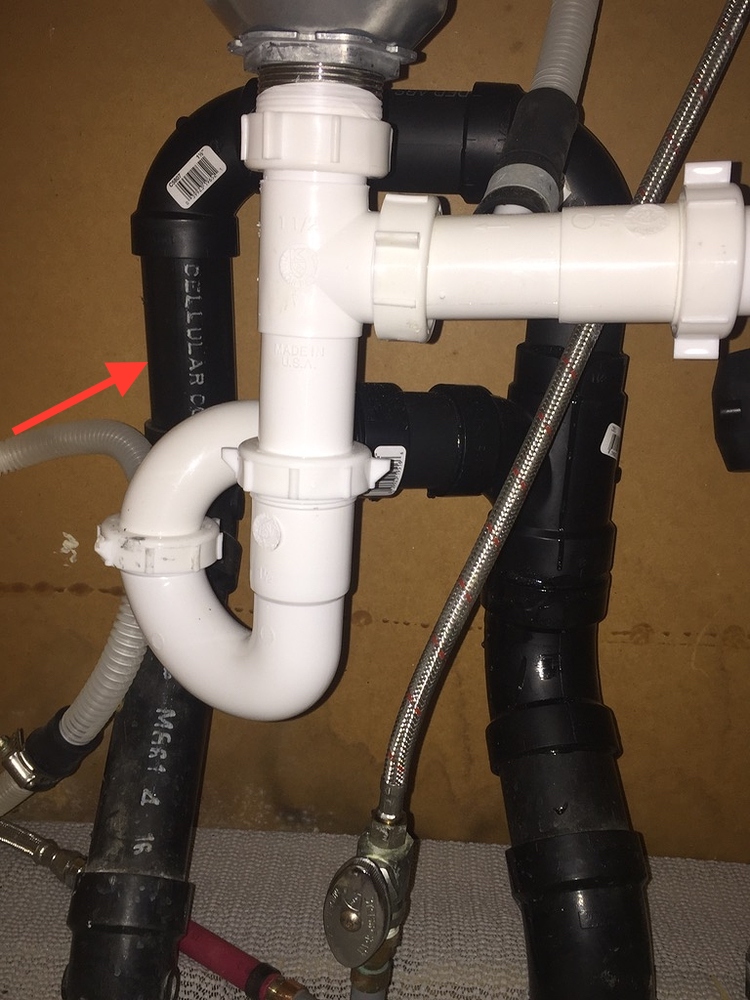

The black abs pipe made sense until you get to the top of the pipe then it goes back down under the house. It is trapped, I have at least 3 inches on the arm, then it goes down into the drain. Good, but what is this mess to the left of it? the pipe makes a big “U”. Like, who designed this mess? Any reason? Ok, go!

is this under a kitchen sink that is on an island or peninsula? (no wall for the vent pipe to hide in)
If so, it may be an “[Island Loop](https://www.finehomebuilding.com/2019/09/10/a-new-old-way-to-vent-a-kitchen-island)”

There is no wall behind it, thats why it goes down to the crawl after the trap. I wondered about the connected pipe to the left of it. It all one big black pipe that both go to the crawl.

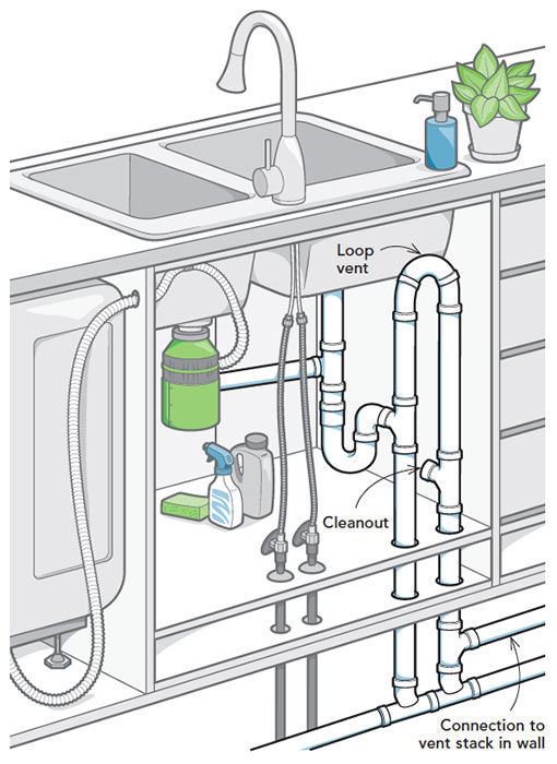

Island loop. its an alternative to an AAV (aka “Studor valve”)
can be used when there is no wall behind the sink to hide a vent stack.

> [@jsaunders2](#):
> The black abs pipe made sense until you get to the top of the pipe then it goes back down under the house. It is trapped, I have at least 3 inches on the arm, then it goes down into the drain. Good, but what is this mess to the left of it? the pipe makes a big “U”. Like, who designed this mess? Any reason?. Ok, go!
It is supposed to be like this:
" An **island vent** rises as high as possible **under** an **island** before running to a regular vertical **vent**. It keeps air **in** the **drain** system and prevents siphoning of the P-trap. Tip: If you plan to attach a garbage disposer to an **island sink** , replace the sanitary tee and cleanout adapter with a flat-patterned cleanout tee."
 ![1](https://global.discourse-cdn.com/internachi/original/3X/d/e/de5bc2199a24bedd2b8e3e59e2f635f010f28a88.jpeg)
Edit: You were too fast for me, Bert! 😄

**Note:** AAV’s are not allowed in all jurisdictions, thus the frequent use of island vents when not in an island!

Is that some kind of flex ABS behind the trap? If so, it’s a no-no. 😄

That’s solid ABS
