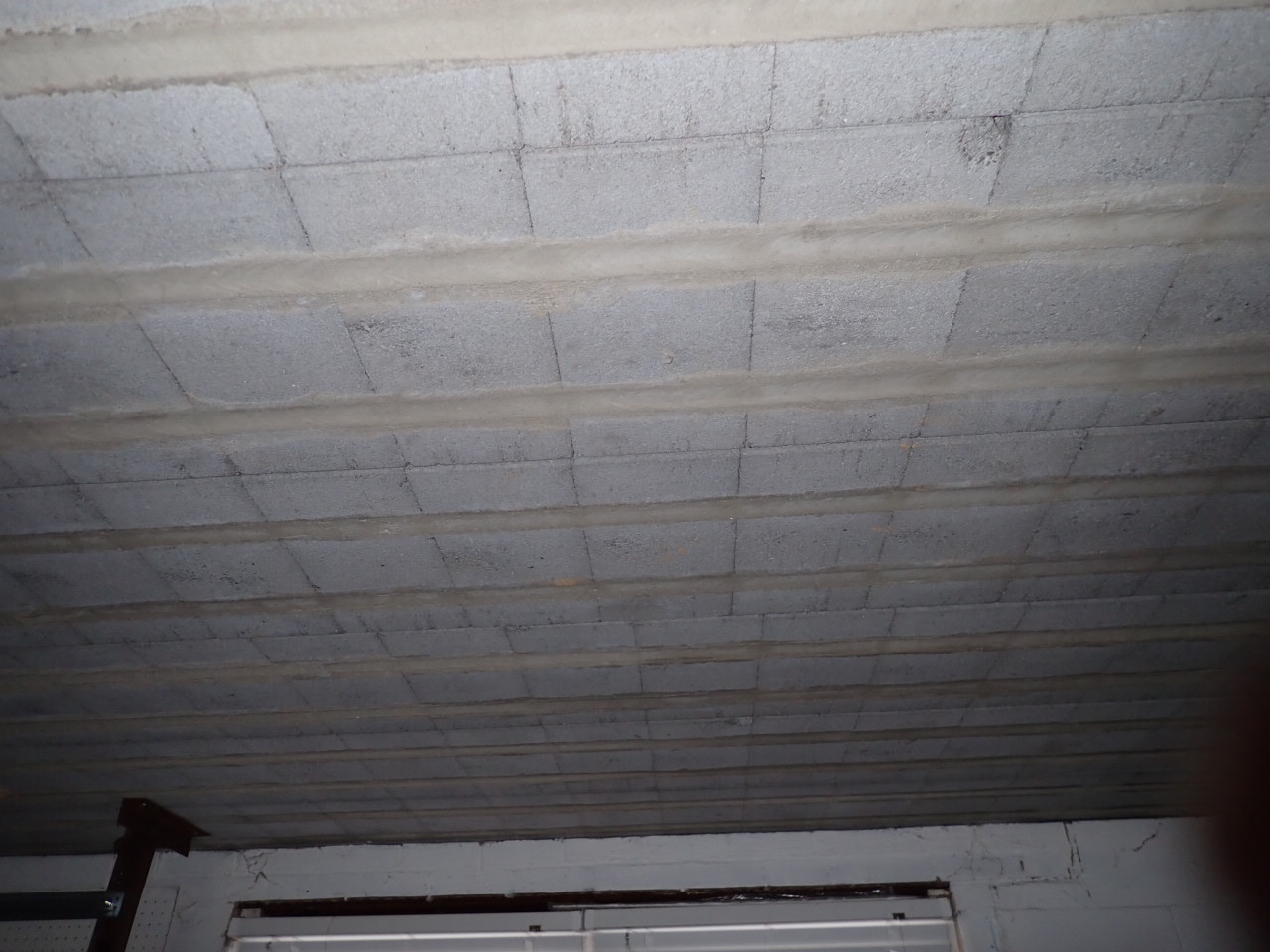

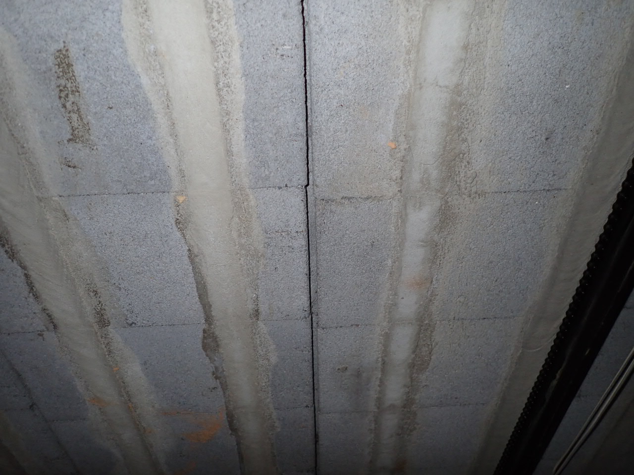

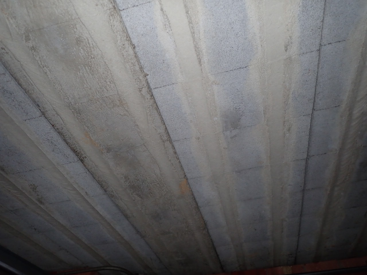

What type of garage ceiling is this?
(Terrill Ewald, CPI, MD# 31310) #1
Home built in 1965. There is rebar inside the cemented areas, but they look like some type of concrete blocks. Just curious, first time seeing this.
(Dennis DiVito, VA License # 3380 000170) #2
What was above this ceiling? It does look like block, but I can not tell

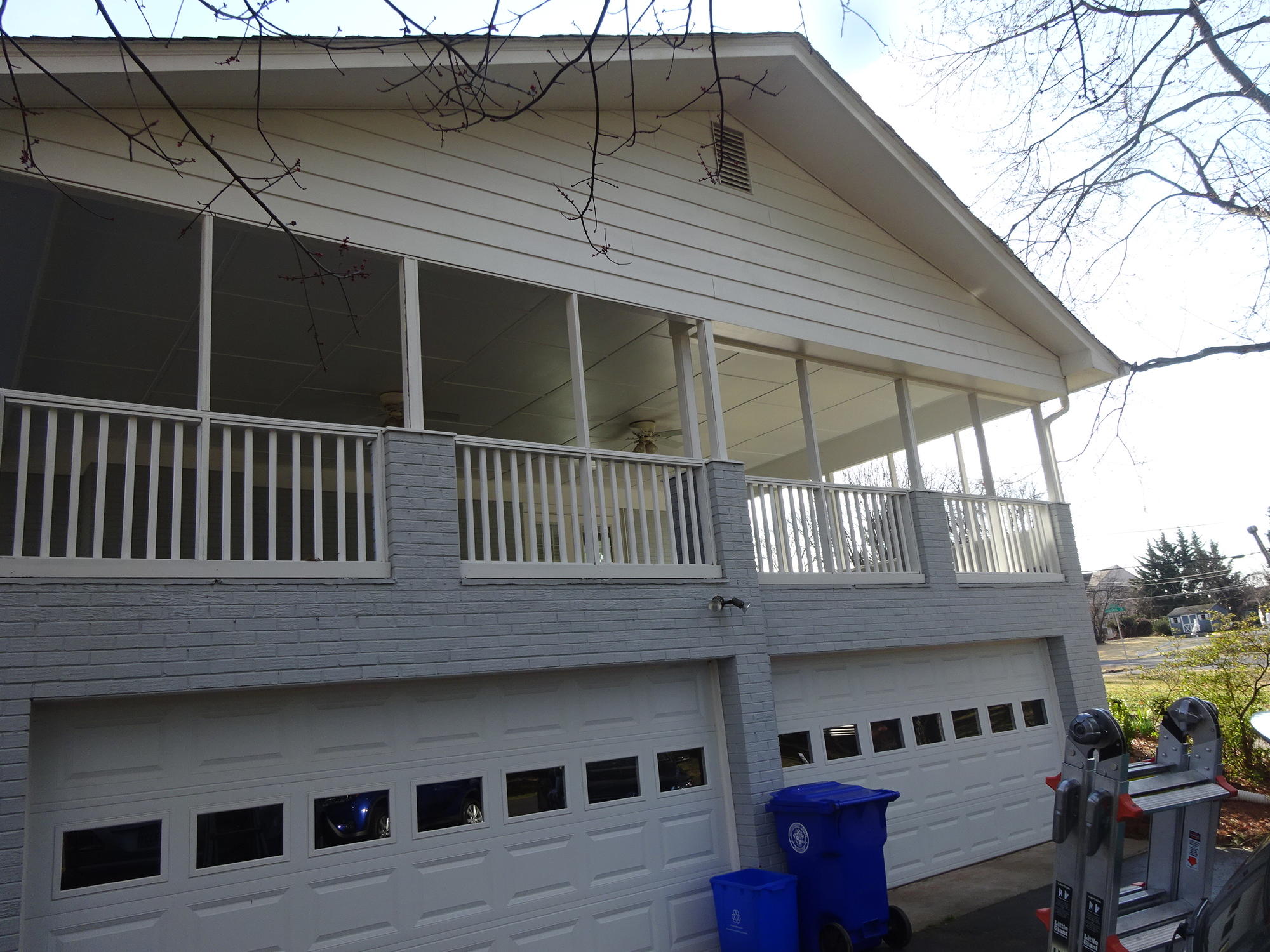

(Terrill Ewald, CPI, MD# 31310) #3
It was a builtup/tarred roof under the rooftop porch
(Marcel Gratton, CMI) #4
I’ve seen that type of flooring used at the Boldt castle in NY 1000 Islands during a tour. The castle was built in 1900. Its a concrete block flooring system.
(Paul Lesieur, CMI) #5
Its a formed and poured slab/ ceiling. You install supports, install decking, tie rebar in a certain pattern, place concrete, finish the surface, remove the forms and supports, install roofing, go home.
