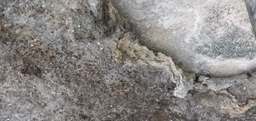

What type of insulation would this be
What type of insulation would this be? 1980s condo looks like cellulose. Never seen this could it be an asbestos insulation?
Looks like the fireproofing.
Sprayed on application to fire/soundproof (with some insulation value). If it’s from 1980s, it may contain asbestos. If the buyer is concerned, it should be tested. Removal/abatement could be $$$
