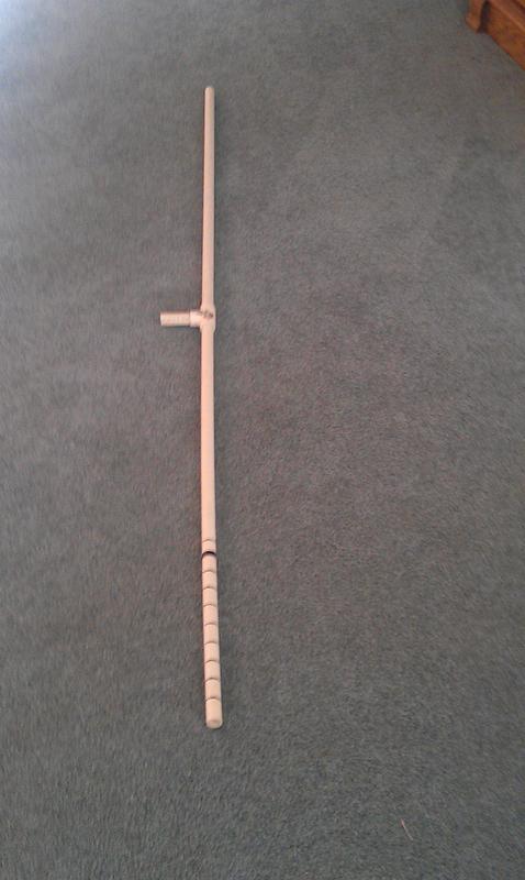

Whats your favorite home made inspection tool? I would like to share my very simple yet useful tool and hope this tool will help you too. I made a multi functional tool that fits in my tool box. I use it to test sump pumps, probing, general measuring, test smoke alarms and check minimum height for over head cables. It cost less $5; its made from 2 pieces of 1/2" x 26" CPVC. One end has a 90 degree elbow used to safely reach and hook sump pump floats. The other end I hot glued a bolt within the tube to expose its hex head making it easier to push on smoke alarm test buttons. The other piece I hot glued a micro screw drive I use for probing. When I put the two pieces together I have 51" of reach that allows me to measure the minimum clearance for overhead service conductor.

Wire coat hangers have got me out of a few jams around house a few times. Don’t recommend using to test sump pumps or hights of over head conductors. Lol
