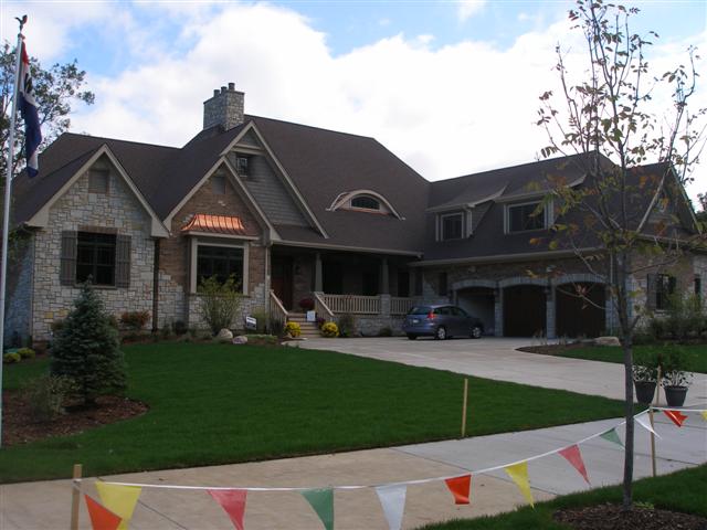

This new construction has 5 fireplaces.

A fool and his money are soon parted!!!
