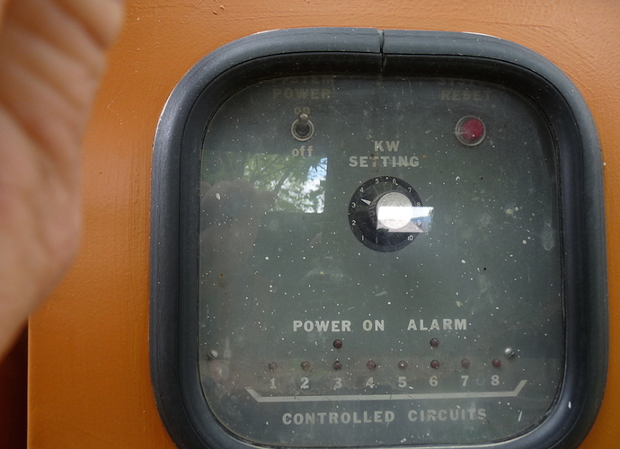

No PV at the house. The little window and dial indicates it’s for monitoring and adjusting something.

Did the home have electric baseboard heating?
It is most likely a demand controller. It will randomly shut the electric baseboard heating circuits off to keep the power consumption below a certain amount.

I’ve seen demand controllers in Boulder, David, none of them had windows, but that doesn’t mean this was not a demand controller.
Generator?

I have never seen one exactly like that either. I took a look at the number of two pole breakers, that was my big clue.
