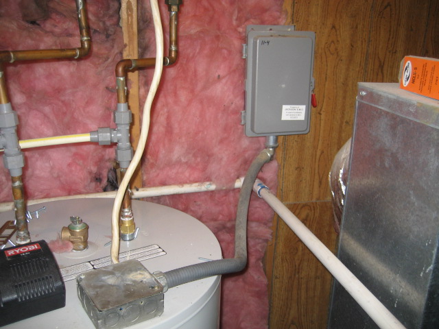

Hi guys,
Found this black box (okay, gray) in circuit with the W.H.
I’m no EE, but from the schematic is this a surge protector?
(yes, I saw the tpr)
TIA,
Tim
http://www.jacksonemc.com/Smart-Meter.smartmeter.0.html
Looks like a transformer.
240v.
I take it this was a electric HWH.
It’s a relay used to control the water heater,
Any idea what DCU stands for?
What I believe that is, is a timer to turn on the water heater at non peak hours to save on energy costs. Sometimes there would be a second meter on the outside just for the hot water tank. That red tag looks like a utility’s seal. Rick

Mike is correct. Allows the POCO to control the energy during peak usage times. Usually get a lower electric rate for being on the program. (note the FCC approval).
Bob… Linas must have really got to you… look at the photo again.
Possibly Demand Control Unit
Something to that effect, being FCC approved, it probably incorporates wireless technology.
I have never seen that kind of unit.
My first thought was Direct Current.

Load Controller, i always note it and disclaim them… Here they were installed in the 70’s and who knows if they are working or not???

We call them On-call boxes, if it is the same. This is what I put.
Not inspected:
There are Big Power on-call boxes on the premises. These units allow Big Power to turn off the power to appliances such as Hot water heater, A/c, Heat and pool equipment at their discretion. I recommend contacting Big Power for operation and discounts available on the electric bill, or removal.

It is an old demand control, the utility company used to give electric bill discounts for having it installed, I have a pile of these boxes from remodeling jobs. I reuse the boxes when I custom wire boats.
