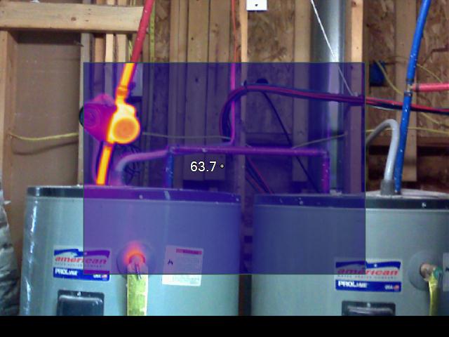

Any guesses?
Do I see red and blue PEX connected on the cold side of the right tank?

Doesn’t look like any TPRV drain pipe either, at least on the right side.

WAG…Left side water heater - Top thermostat is defective, causing the element to keep heating the water of the top part, and not cycling with the bottom heating element.
Water heaters in series rather than parallel which is preferred.
Right side tank is not heating water.
No T&P drain lines.
Recirc pump looks active.
Also hard piped without unions.
The right side tank may be turned off when the house is not occupied by many people, it may also have a bad upper element since no heat at all is coming out if its not switched off on purpose. If its switched off on purpose, the recirc pump needs to be turned off also or the return rerouted to the left tank.
The recirc pump should be in the return line so its not handling the hottest water (unit will last longer).
I don’t see any check valves, were they present ?
Looks like one or two TPR extension pipes are missing too.

I’ve never came acrossed series hot water tanks (yet) or cirulation pumps. I agree with Bruce, I figured warmer water would be coming out of the right tank. Could there be a slight blockage on the incoming line (from the right tank) on the left tank? Temp looks cooler after the 90.
It looks like the downsteam tank is the only one on/working.

House was empty so I had to turn on both electric water heaters.
Yes both T&P missing but that was not the real issue.
The right tank was not working. After the heaters ran for about an hour or so I turned on the circulation pump. The left tank produce hot water and the right did not. Since they are in series water came into the right tank and out/over to the left
The thermal was just for reference. I took my hand and touched the line to make sure both were working.
If the right was workng then I should have had hot water. Even if the bottom elements were burnt out I still would have had some hot water.
