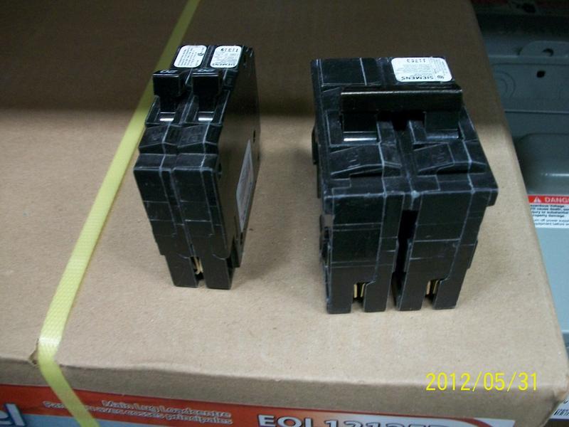

Here are two double 20 amp breakers one is Both on the same phase .
The other has one one each leg One red one black .
uote: Originally Posted by rcooke http://nachi.cachefly.net/forum/images/2006/buttons/viewpost.gif
I think this is what some call a half breaker and they are fed from a single phase .so two on phase B overloads the neutral

Anyone care to comment on this pic taken today…
Without any additional information it’s looks OK.
Marcel can you post that in a new thread and get some comments on it. I have idea what that set up is
Ok so they are quad breakers. The only thing I see wrong is the top one does not have a label anymore so there is no way to know if the conductors are sized correctly
The colors of the handles are consistent - 15A = blue, 20A = red. I would have checked (if possible) to see what the outside poles of the bottom quad are connected to - may be a handle tie missing.
There wouldn’t be a handle tie missing it would be imroperly wired. The diagram shows its not supposed to have a handle tie
Geez - I’m batting .1000. Time to retire for the night!
Well I didn’t realize it was color coded so don’t feel bad. I also spent the last hour looking up quad breakers and staring at that pic trying to figure out what marcel wanted us to see.
The are both a single pole-double pole-single pole and a double pole-double pole breaker shown.
That brand of panel allows a breaker to be offset by 1/2 a space to allow a 240 to grab both legs. Not a common design.
My concern is with the 2 double pole breakers which are for kitchen countertop split receptacles.
Why do you feel that it may be a problem?
