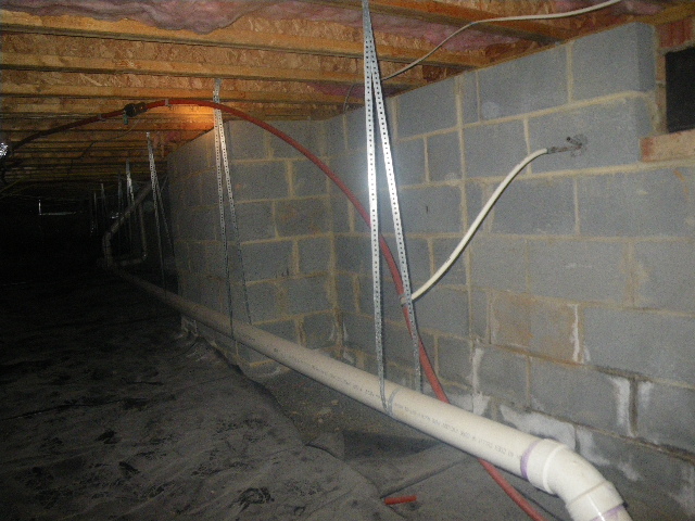

Water service pipe enters the foundation wall at the bottom right of the photo. See anything wrong?

That rule doesn’t apply to plastic piping, which are 100% of the time laid in the same trench to the home. Nothing wrong there. The issue is in view. Not waste pipe related at all.
Fudge.
PEX pipe requires horizontal support every 2.67 feet
Hint: that black thing at the floor joist is the pressure reducing valve.
Whatever that white pipe services (hose bib?) is seeing full pressure
Ding! Ding! Ding! Ding!
Whether or not the pressure at the hose bib was < 80, it could be > 80 depending on the time of day you measure it. And it could be higher at any point in the future if the municipality increases system pressure.
Did it go to a hose bib or a sprinkler system? A Tee prior to the pressure reducing valve is quite common for landscaping purposes and distant point of use faucets especially on larger parcels.

Hose bib.
The location of the regulator is more of an issue than the fact that an exterior hose bib is not regulated.
The pressure should be regulated before it enters the structure, not somewhere within.
Around here it is common practice to allow an exterior hose bib to be off the regulated system. I have argued this case in point before.
It may be common practice, but it is a defect in my opinion. There are at least 2 fittings (at the T and at the hose bib) that could be overly stressed by high pressure and flood the crawl space.
Regulators are often in crawl spaces and I don’t have a problem with that (but admittedly not the most convenient location). A crawl space is defined as “accessible”. I’m not aware of any code that states where the regulator has to be located. There should be no fittings prior to the regulator to prevent leaks, however. I wouldn’t allow any fitted connection in the service pipe anywhere prior to the regulator (service pipe should be one piece).
I disagree with your interpretation that a crawlspace is considered “accessible” with regard to systems/components located within. It may be a regional thing, but CA crawlspaces are certainly not a “convenient” location for any service or repair.
Additionally, CA code allows for exterior hose-bibs to be unregulated with regard to pressure.
CPC 608.2 Excessive Water Pressure. Where static water pressure in the water supply piping is in excess of eighty (80) pounds per square inch (552 kPa), an approved-type pressure regulator preceded by an adequate strainer shall be installed and the static pressure reduced to eighty (80) pounds per square inch (552 kPa) or less. Such regulator(s) shall control the pressure to all water outlets in the building unless otherwise approved by the Authority Having Jurisdiction. Each such regulator and strainer shall be accessibly located above ground or in a vault equipped with a properly sized and sloped bore-sighted drain to daylight, shall be protected from freezing, and shall have the strainer readily accessible for cleaning without removing the regulator or strainer body or disconnecting the supply piping. All pipe size determinations shall be based on eighty (80) percent of the reduced pressure when using Table 6-6.
Just because it’s inconvenient or that you have to crawl or get dirty doesn’t mean something is “inaccessible”. There is a difference between *accessible *and readily accessible, yes. And the CA nor the IRC states that the valve must be conveniently located.
Your CA code specifically states the strainer should be “readily accessible”. But the reducing valve just has to be “accessible”. The IRC does not state the the reducing valve must be “readily accessible”. (I’m not familiar with a strainer at all.)

Your correct and if you were the AHJ in my area you could enforce this, but unfortunately the ones who are find this practice acceptable. :neutral:
I just smile and tell the buyer to buy a really good hose for the front yard.
I concur…
