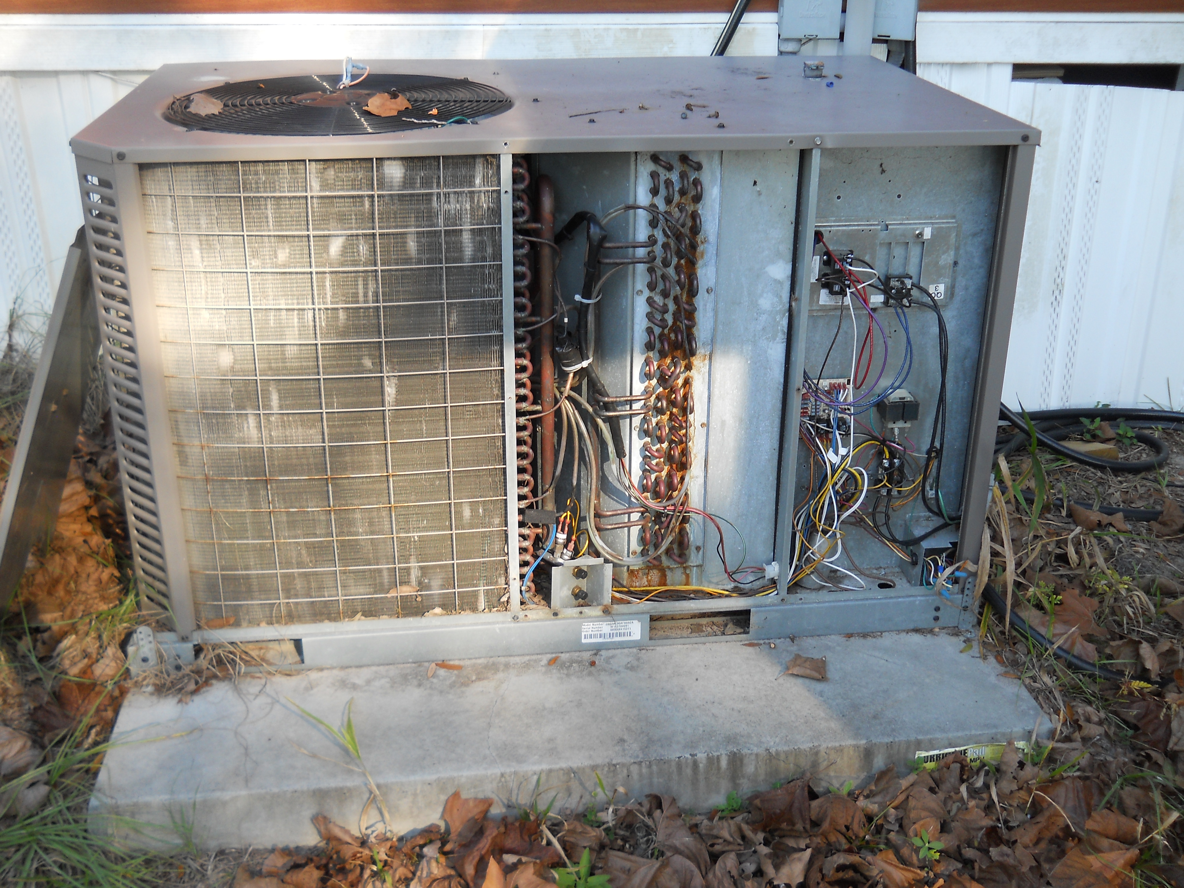

That the heat pump ain’t gonna work… ! Huh?

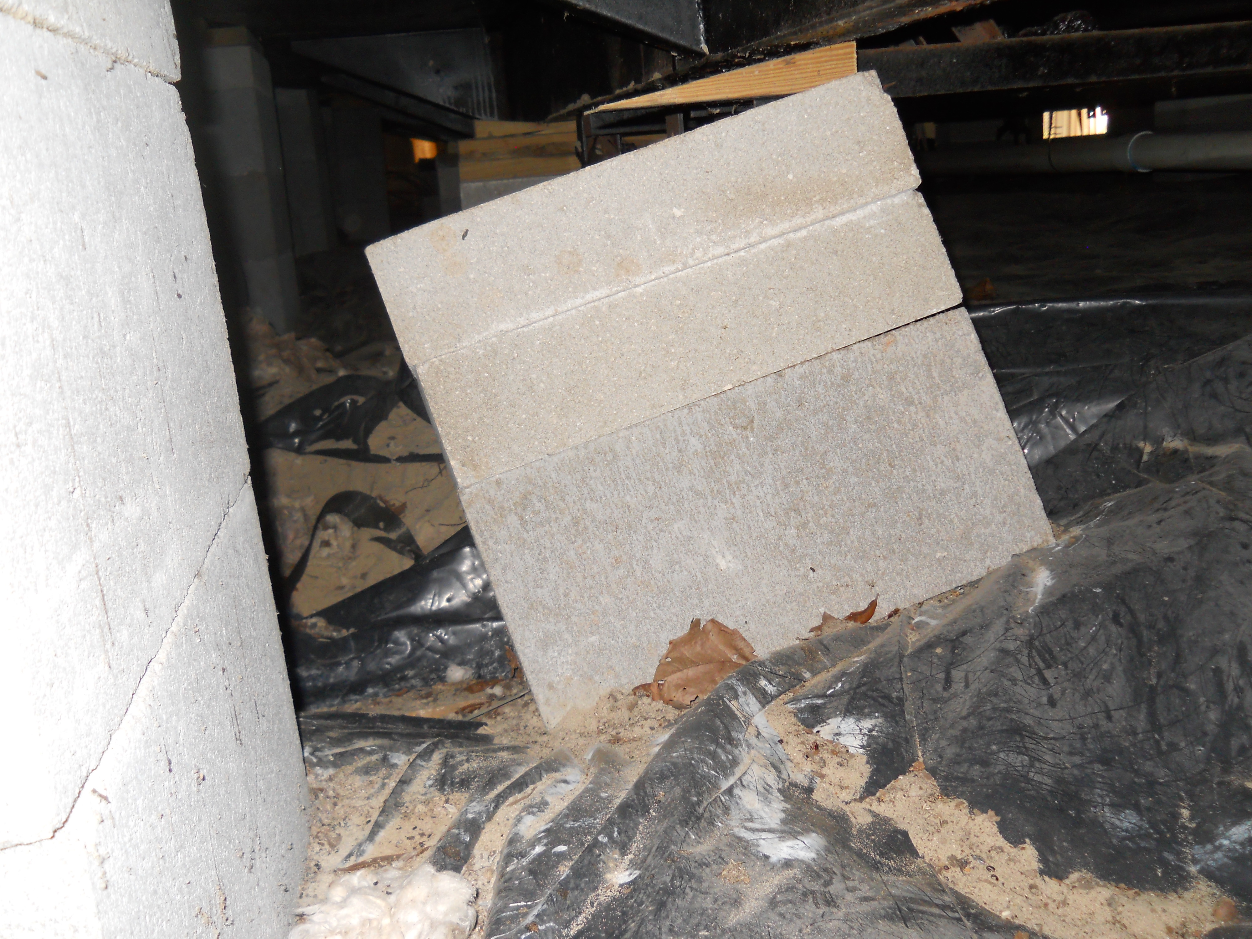

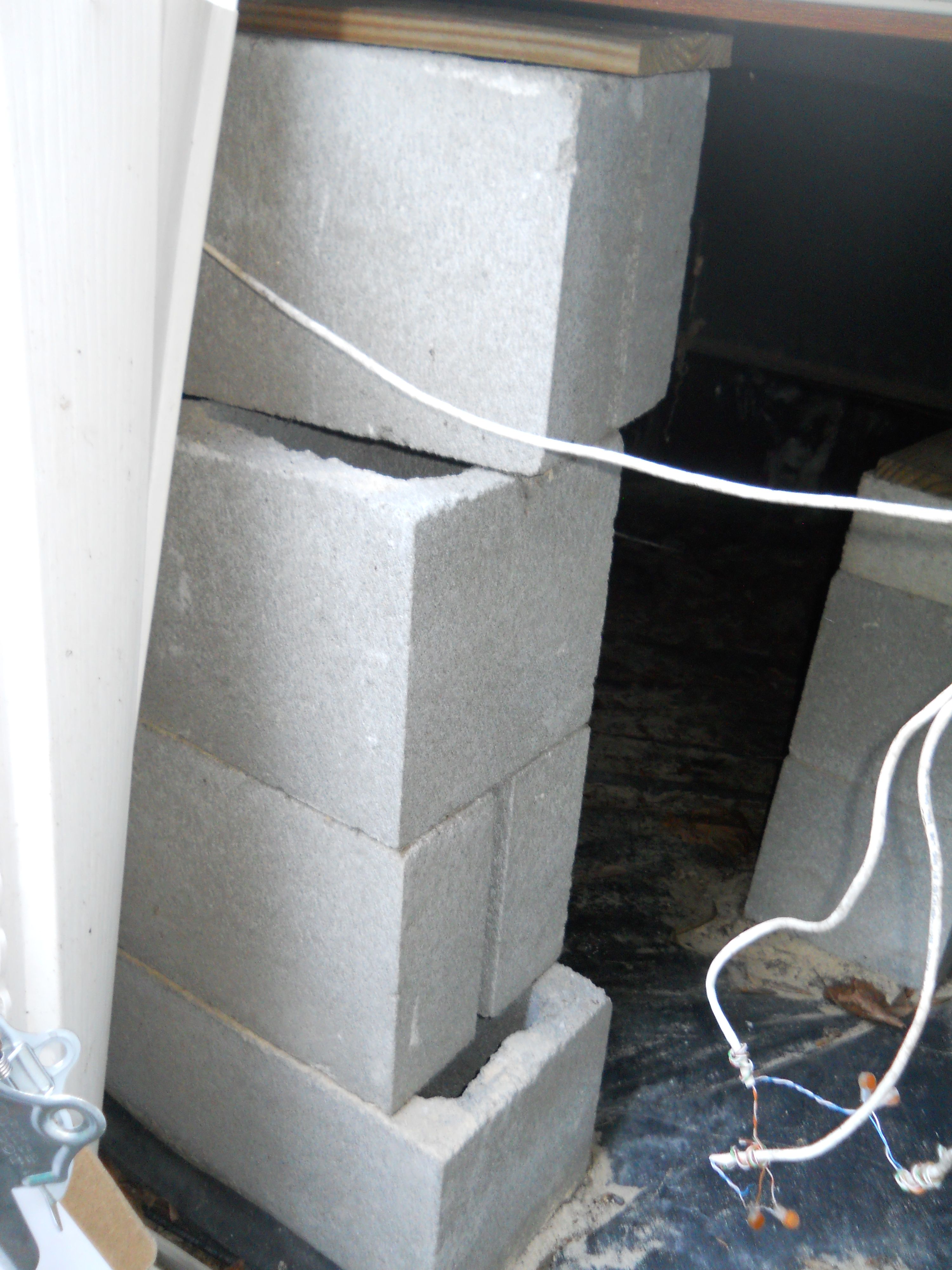

That the piers are all screwed up… Huh?

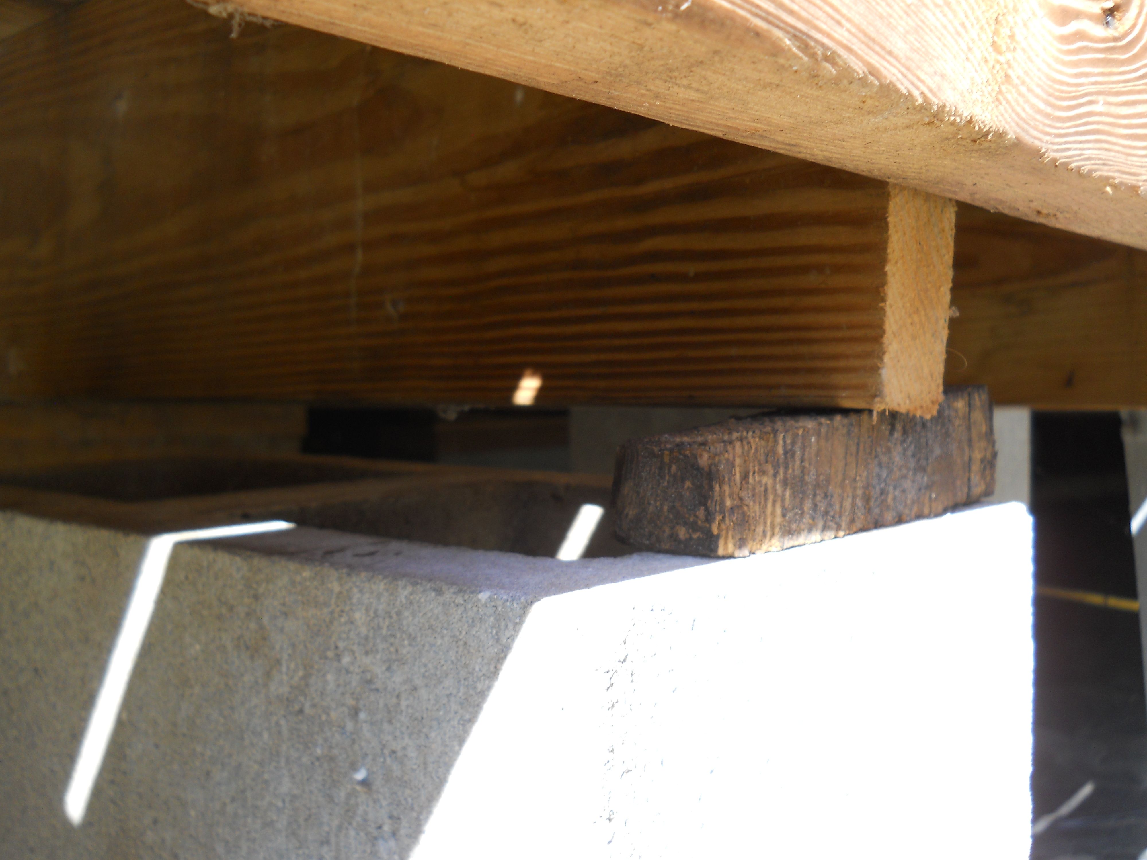

And last but not least! That Billy Bob didn’t know jack crap on how to put a porch on a double wide… Huh? That support member is on the roof shingles… Wow!

Was the heatpump open like that when you arrived?
Just like in the image.
That’s a 2013 York heat pump package unit.

Manufactured homes fall under HUD guidelines. It had all had all the proper Oliver bracing and all the tie-downs were secure. But in these little counties that I work in. Get this Dixie County. It’s a little bit laxed.
What happened to most of these piers is lack of gutters which caused the perimeter Piers to fail And lack of proper skirting. Which allowed armadillos in which burrowed under the pads.

He removed the covers to facilitate your inspection…
Nope! It has been open for a while.
