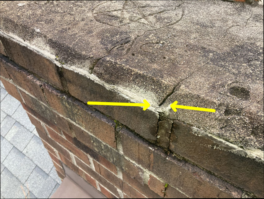

When you take a pic of a simple defect...then it appears

Just wondering if I should include a picture with a pentagram engraved on the chimney cap. :man_shrugging:
Depends on who you’re asking. I would not find the pentagram to be offensive but others might. Would you be asking the question if there was a cross or a star of David in the photo?
It keeps the witches from going down the chimney! I would include it, no problem.
If you have any concerns, just crop the image down.
Crop and dismiss. Not our job… :wink:

Good point. I would just ignore it like it wasn’t there. I do not crop these out.

I thought it was just a star. Nothing special. Include it.
Pentacle. Wards off evil spirits. Keeps unpleasantries from swooping down the chimney.
From the looks of your photo - that one may be expired. :flushed:
It also looks like you have a “J.C.” inscribed below it. Brick mason was having commitment anxiety.
Good question. I would include it. It can be left or removed this way.
Also Note; the crown was not proportionately site manufactured. It does not provide complete protection for the brick masonry below. It should be 4" inches wider than the brick masonry and have a capillary break.
I’m thinking I would be recommending further investigation by qualified professionals image
Great catch, Thank you Robert!
Whatever it is, it didnt ward off the 4 Bats I found in the attic! lol
What would a capillary break look like on a chimney?
