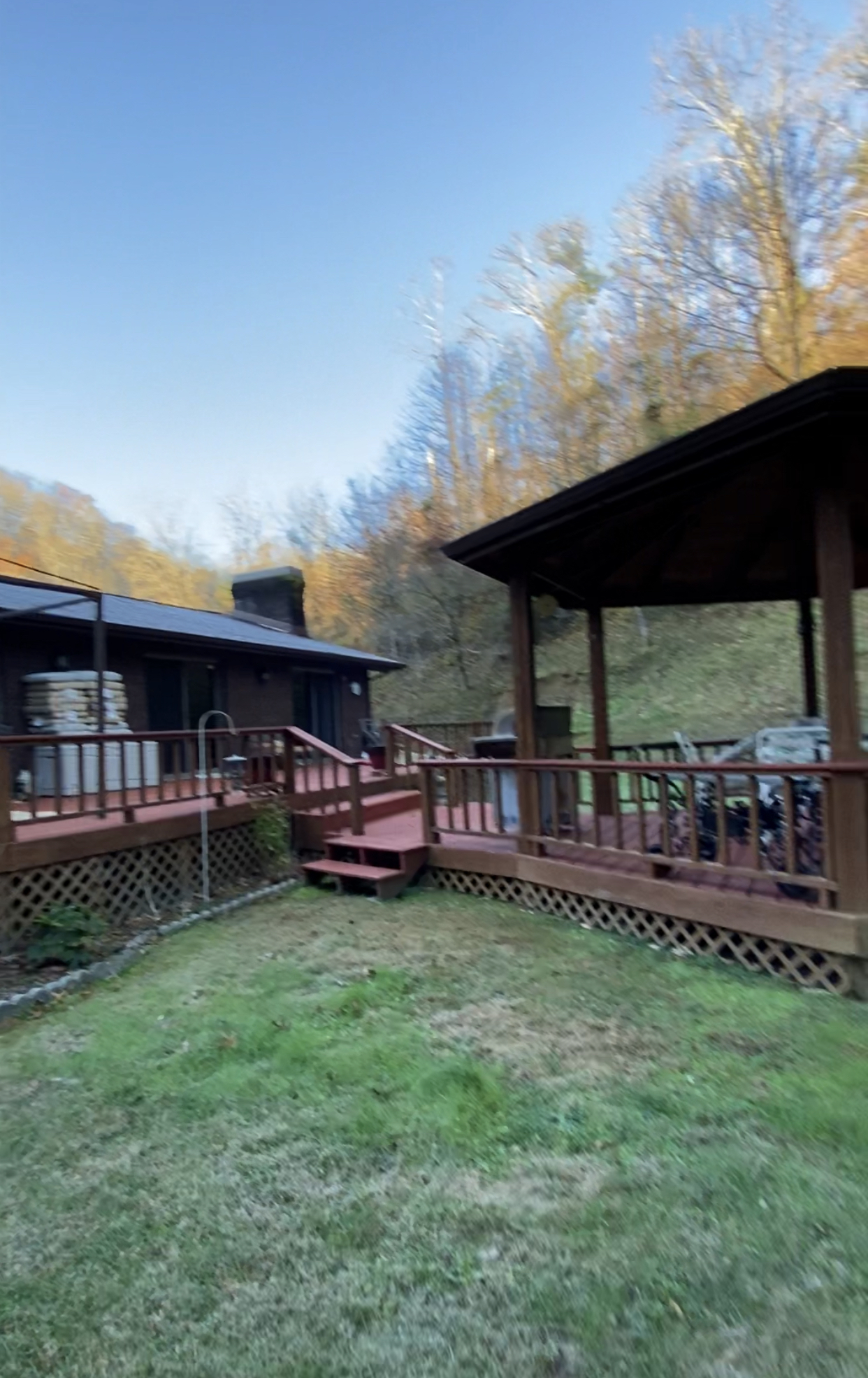

So where do you quit inspecting this deck? Sorry, this is the best picture I have at the moment. It stops at the gazebo pictured. Do you inspect all of it including the gazebo?
what did You agree to inspect when You accepted the job ???
Well… I had no clue there was a gazebo or a deck to be honest.
Does your SOP say stop at the gazebo?
My state utilizes NACHI SOP so not that I’m aware of.

Personally I would inspect it. Honestly how much extra time could that take?
I’ve inspected many homes that say they have a deck only to get there and then I have three or four levels of decks and balconies, a whole lot bigger than what you’re showing.
Same here. I don’t have it (gazebos, unattached decks, etc.) set in my report but will let the client know via email that it was inspected as part of the property and list any concerns and issues if necessary.
Yup I’ll do an inspection on the beach and the damn deck goes on forever. Just do what you say.
Now you have another question to ask at the first phone call with the potential client. :smile:
Was there no listing online to view? A deck like that and gazebo are selling points. Would have been photos. Granted listings are not always accurate, but are a great source for information about the house.
If it’s there, inspect it. Nothing to lose by doing it other than a bit of time.
Why wouldn’t you inspect the deck and gazebo? They are pretty common and normal to be inspected with the home inspection. And by looking up the home on the realtor site or realtor.com you will get many photos and a write up so you know what to expect, even though there will be surprises! The only time you don’t do something is if you can’t gain access, if it’s unsafe, or beyond the scope of your inspection and not agreed on…then disclose what you didn’t inspect and the reason why.
You can’t price out something if they don’t tell you about it…do what you’re comfortable with only…otherwise disclaim it by saying it was not inspected because it was not revealed to you when you priced the job. Decks especially can have a lot of defects…why waste your time on something you’re not getting paid for (and possibly could be liable for)? Sometimes I’ll include pictures of it with the caption that it was excluded from the report…in that way they get a feel for the dilapidated shed, outbuilding, deck or whatever and you don’t have to write up all the defects.

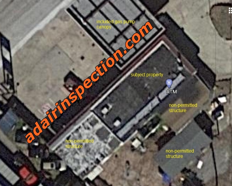

before i even bother to quote i have an addy & look up the property on google maps-earth & the tax data & sometimes permits when i’m pretty sure things ain’t what they say they are
i like to know where i’m going, what i’m inspecting & what the prop looks like beyond the listing pix
flat fee & sq ft will really bite ya if ya ever delve into more lucrative commercial or industrial
this request for “what do you charge” wound up being almost 5 times another firm’s ordinary sqft quote after i spelled it out line item in the agreement-contract
if all else fails fill this out
