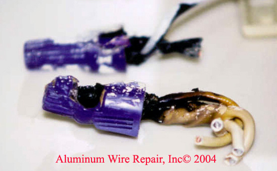

Why are these nuts purple?
And what are they used for?
Approved for aluminum/copper wire “pigtail” splice for older style receptacles.
More info:
http://www.alwirerepair.com/burned_purples.htm
http://www.inspect-ny.com/aluminum/i65debat.htm

Why are THESE nuts purple and BLACK?
From Larry’s links above.

Ben,
Where did you get the information that these are “approved” splicing methods?
They are UL Listed for connecting CU and AL, but should not be suggested (by an HI) as a permanent repair method for the older AL wiring of the 70’s.

I would NEVER use those wire nuts. I have a picture of one in a house I flipped when I was upgrading everything to CU, I’ll try and find it, was burnt like the photo’s posted here.
Where did you get your information about these things being good for anything?
From the Ideal site in their own words!

Was gopig to send people to Dan’s site but had to run. About 15-20 years ago, he had pictures of anti-oxidant paste burning!!! Does he still have those photos up?
The purple wire nut (when used with antioxidant cream) is UL approved. NEC 2005 allows for the use of UL approved electrical parts.
The CPSC, however, has condemned this splice (which the NEC is actually silent on) as unsafe due to the numerous fires that have resulted from their use.
