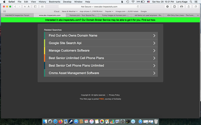

Larry, did you know your website has expired?
I just clicked on it and it went straight to it.
Wow that’s my old web address.
This is my current address
https://ABuyersChoiceHomeInspection.com/
