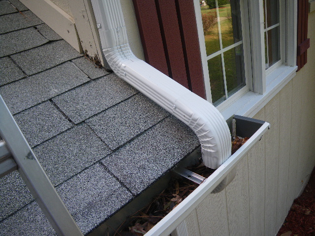

2nd level downspout into a first level front porch gutter. I can envision large splashes over the top or behind it onto the fascia. Thoughts?

Better than dumping it on the roof though.
Must admit I see it all the time that way.

I normally see it to the roof and divertors to deflect the water into the gutter.

Have seen this also - and yes, typically splashes over with a big rain. And with just a little debris, even worse.

Will not work with all those leaves in the gutter. And will probably spash over like Andrew said with a big rain.

Not to mention the lack of a kickout flashing and the trim board laying on the roof. There appears to be some rot and paint deterioration already.

Noted that Mike. Thanks.

Noticed that right away but figured you would not have missed that.
