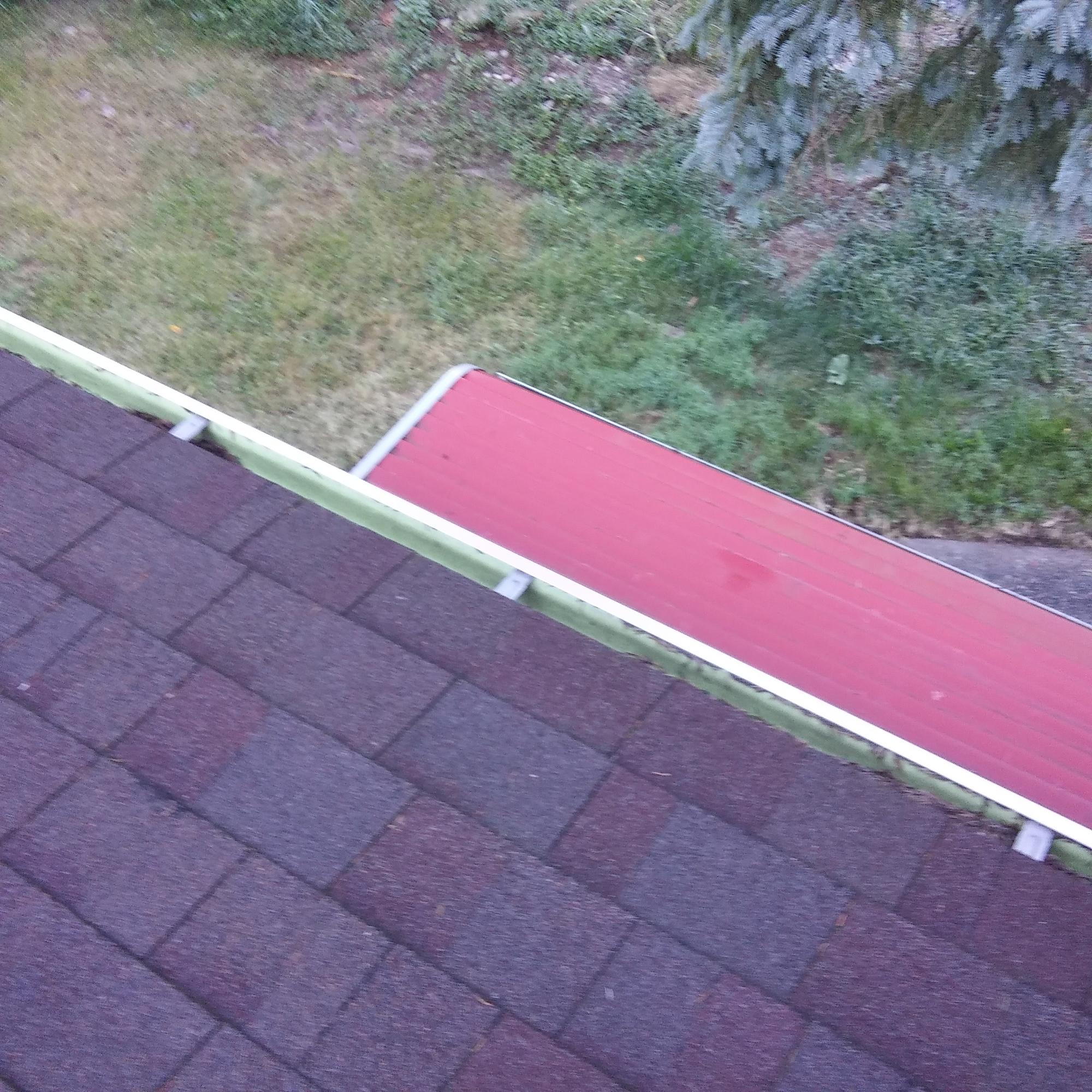

Hi fellow students,
This photo shows a loose shingle which is allowing the roofing nails fastening the flashing to the roof deck to be exposed to moisture intrusion.
The flashing is around a chimney penetration on the downward slope side of the chimney.
My regret is I should have taken an additional photo from a distant view to more clearly illustrate the location.
The homeowner apparently took the insurance money and did not have shingles replaced after a hail storm hit the area. A few years later, this is the result of their negligence. At what cost now did they save that money when they are trying to sell?

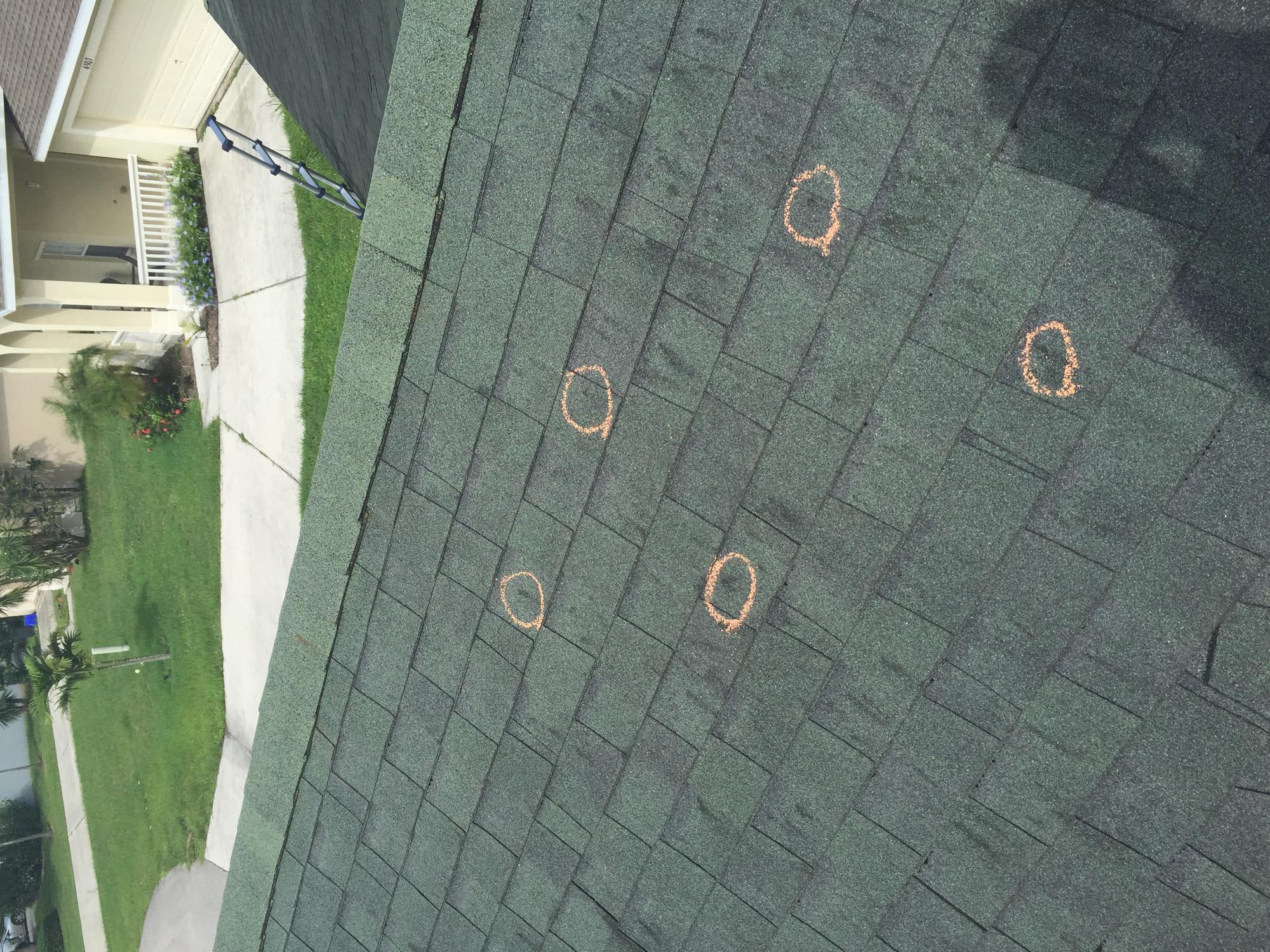

This picture is of a couple hail hits that would be in my 10’ by 10’ text square, my ladder in the back ground is 3 feet above the roof line. These hail hits where 1-2 inch hail. :slight_smile:
The Photo that I uploaded was of the East slope of the house, this photo is of a test square a couple of the hits that were in the test square. My test square is 10’ by 10’ feet. As you can see in the back my ladder was 3 feet above the roof line. The hail here in the photo was 1-2 inch hail. There were 10 hits of hail on this slope. I am showing 4 hits of hail in this photo.
