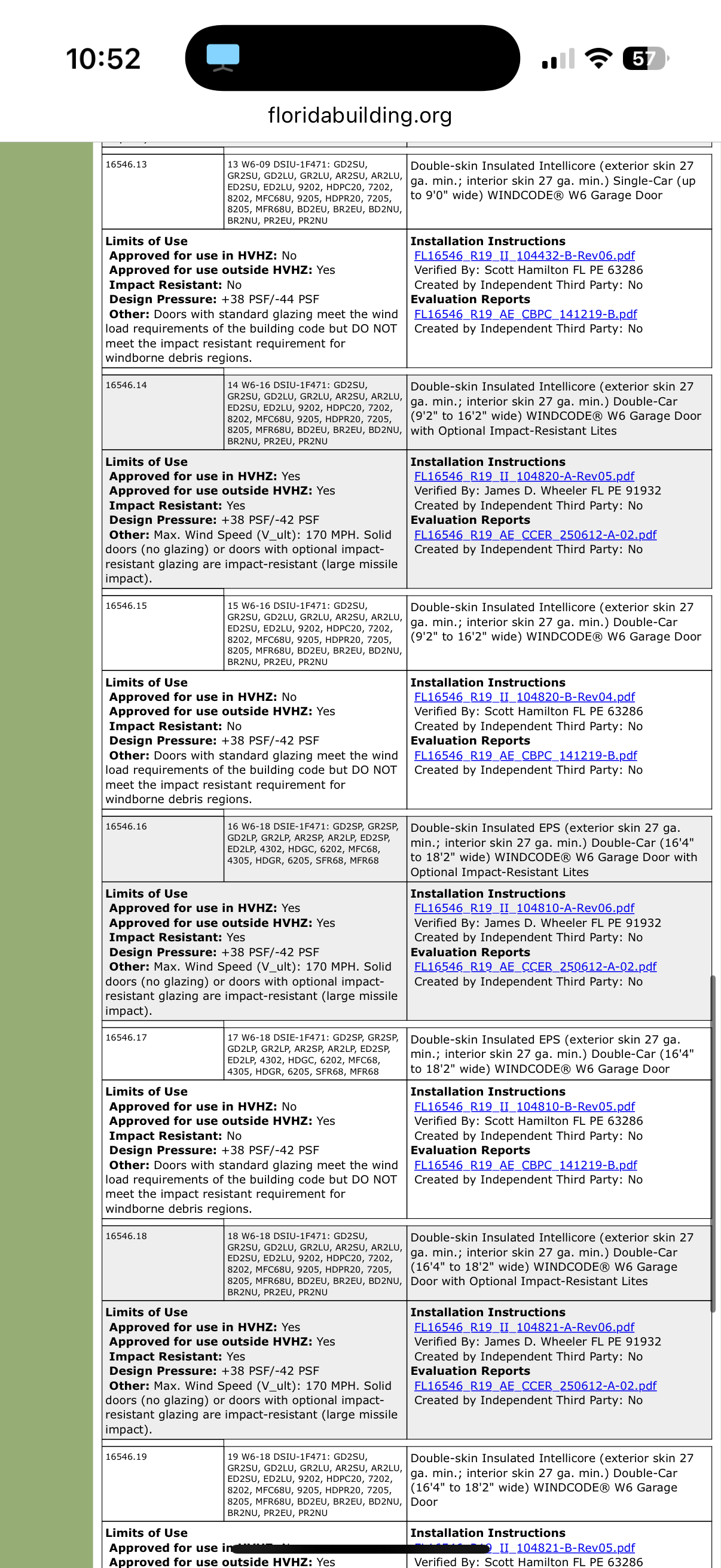

Florida product approval confuses me occasionally because I’ll get an approval # but no revision digit following it.
I get a product approval #: 16546
How do I know which revision it is on the website??
thanks for any help!

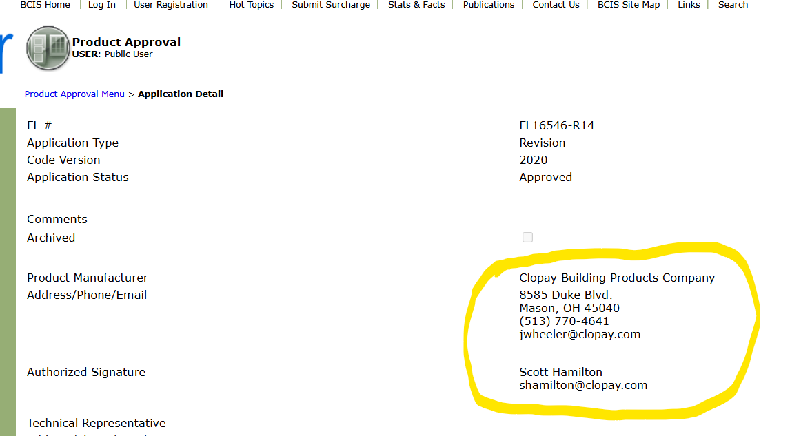

Not super sure
Here’s R14

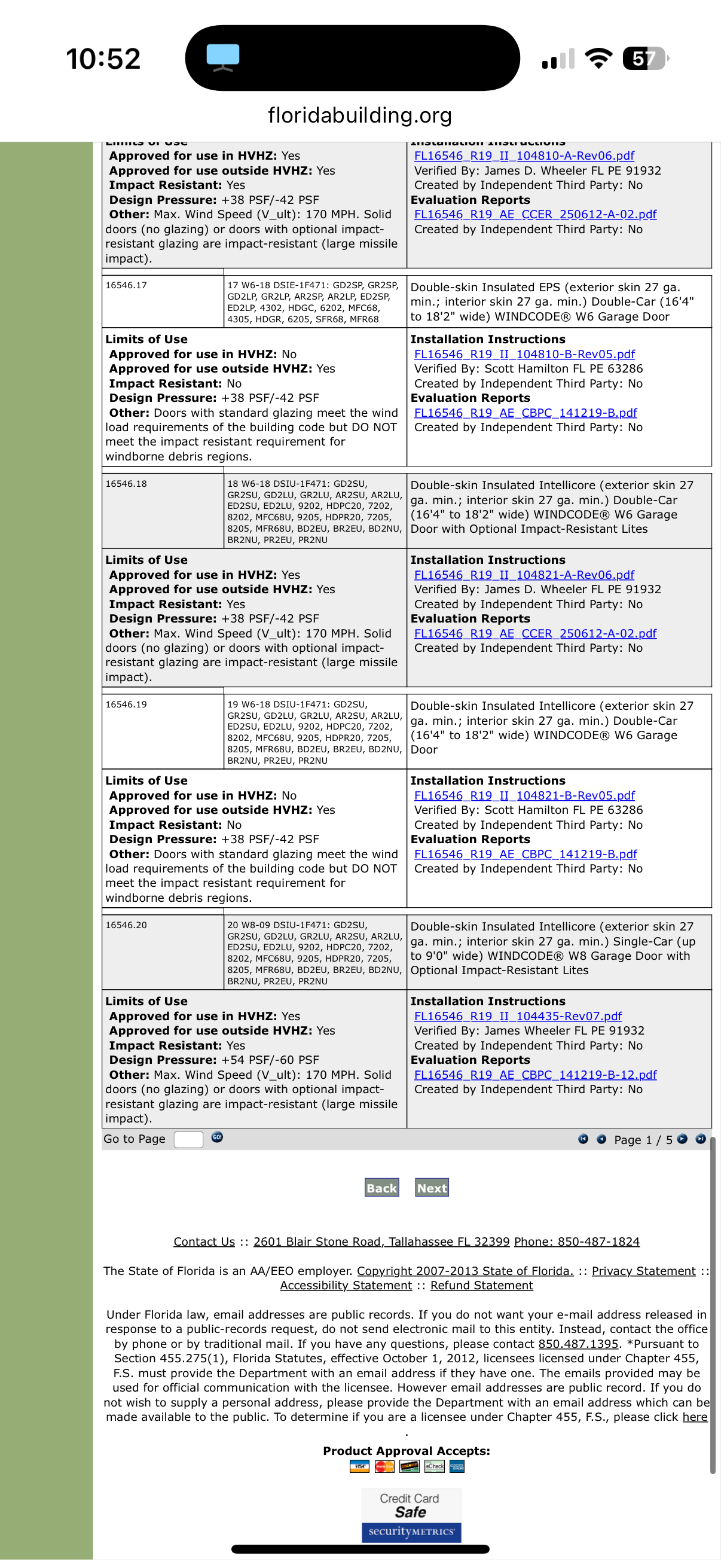

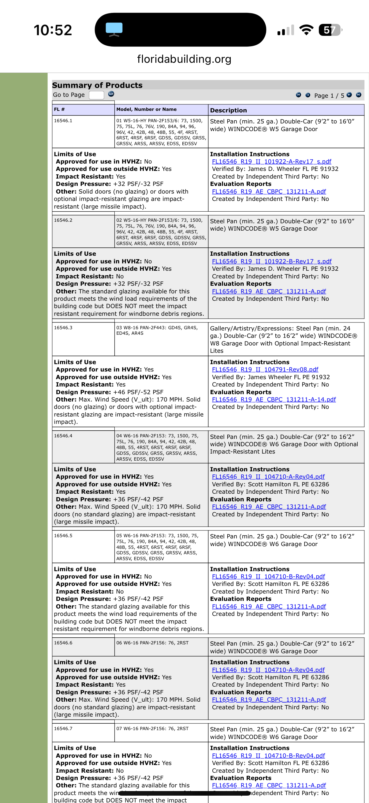

The revision number is typically listed on the Product Approval Index Sheet in new construction.
My WAG on this one for the OHD’s is they are different Model #s. Be wary, some are HVHZ approved some are not.
Any recently installed garage door should have a lable indicating what it is adhered to the inside of the door. Usually, whomever installed the door will have their info on a sticker on the inside of the door and you can call them to determine which one they installed.
