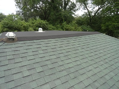

You mean like this? Why some one would lop off the top of a perfectly good hip makes no sense
Exactly.
