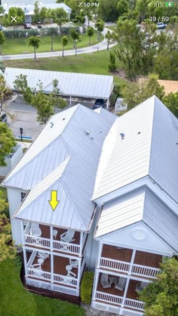

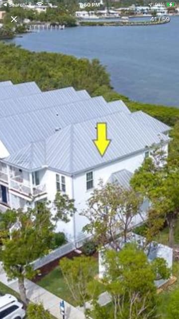

Wind Mitigation Roof Geometry On a townhome
What would this roof be classified as on a wind mit report? What is throwing me off is that it’s attached to the rest of the complex.
Not sure what your question is. The only gable you have is to the right at the rear. So you have to add up the entire roof perimeter, and see if that gable is more than 10%. If so, that would be marked ‘other’.
I think I understand what you are asking. You have to treat the entire stucture as one, since they are framed together at the roof structrure. You cant just use that unit in the calculations. If the front of the left unit is also gable (looks like it may be) it is definitely ‘other’
