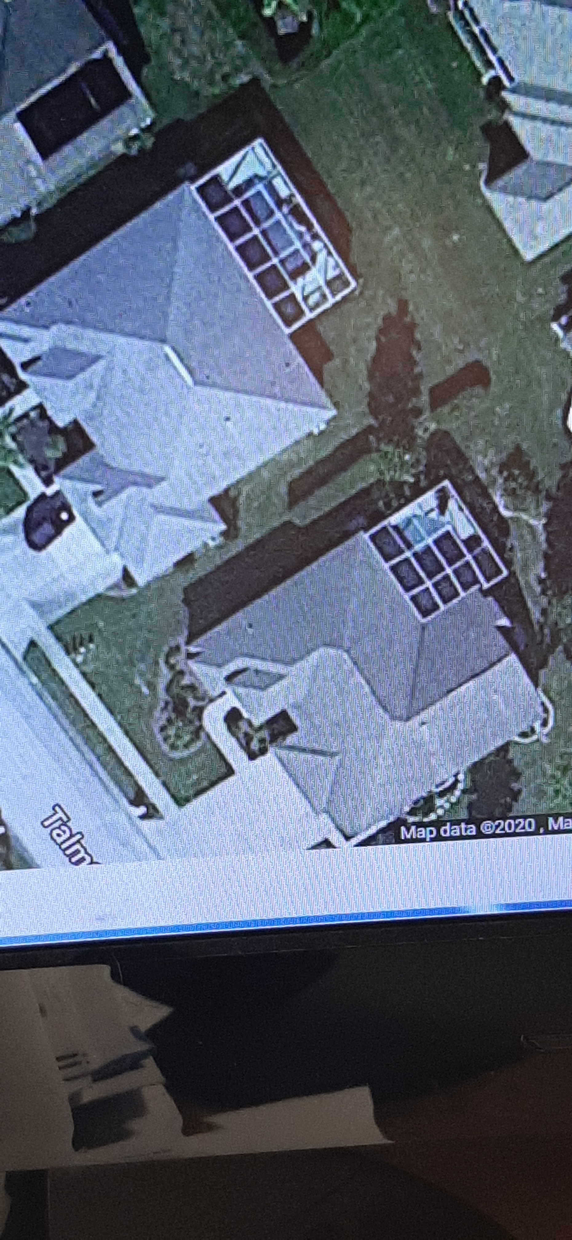

Wind Mits Hip Roof
Roof on lower right, the back section is non hip.
Then calculate it as such.

I was trying to clarify where to start and stop the non hip measurements from?

Meantime, I suggest you ask your question with more clarity, and more completeness. Are you asking how to measure a roof’s geometry?

I was trying to clarify where to measure the non hip roof from the hip roof. Like where it intersects?
I know you measure the perimeter and divide by the non hip. They intersect.

Maybe you’re overthinking it a bit. Measure the horizontal or linear length of the roof’s edge, and total the amount of “non-hip” features. Use those numbers to calculate the percentage of non-hip.
Where the roof starts to transition is where the hip starts/ends. If the gable (or whatever) measures 30 feet across, that’s your length of that specific non-hip feature. You may have multiple non-hip features to add up.
