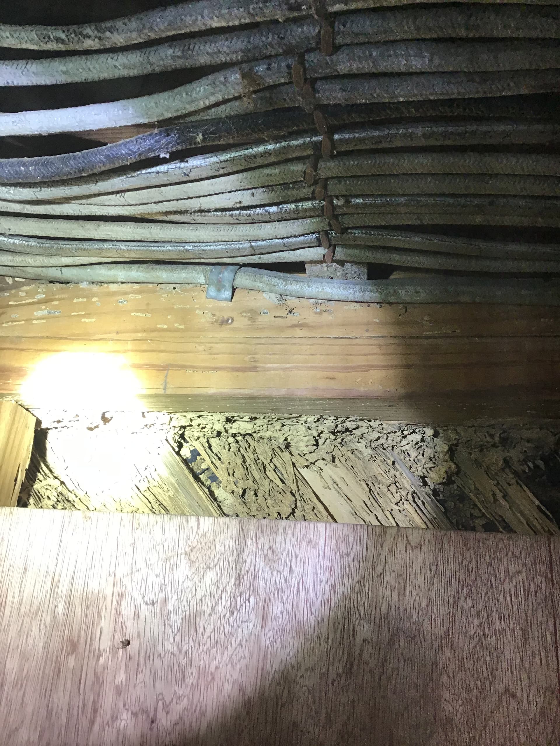

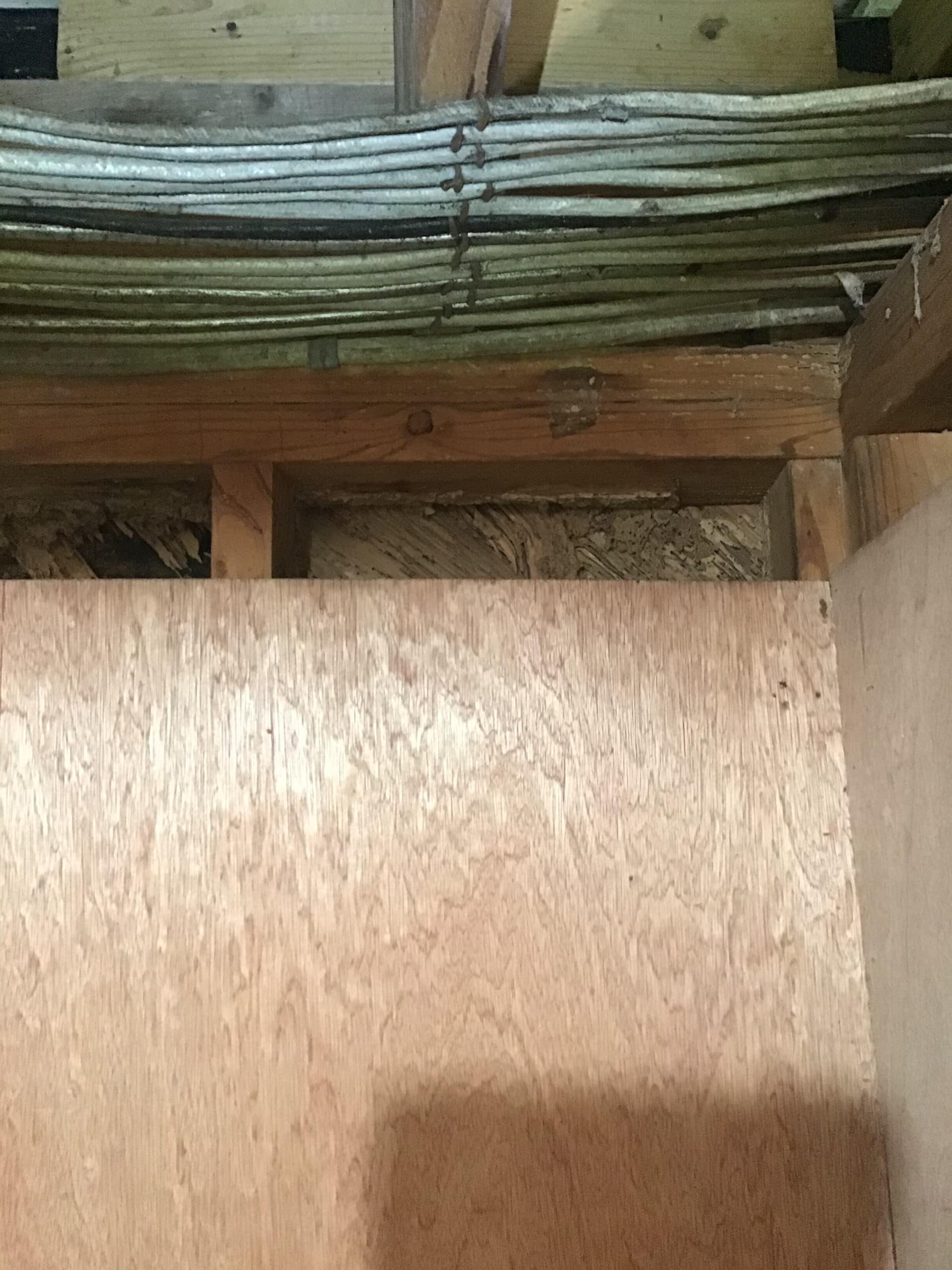

Wood damage or decay
Some new lumber had been installed around these areas. I’m not a WDI inspector - pest damage or decay?

Old House Borers!
I bet it looks the same tomorrow…
The page keeps crashing when I try to upload. Hope these work!
Wood destroying insect IMO from here in GA
Termite damage.
The damage goes with the grain of the wood.
Subterranean Termites are lazy & do not go against the grain.
Note the mud they brought with them from the soil.
Excellent example.
