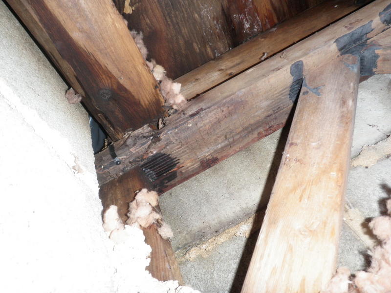

Did a typical water intrusion inspection for a local condo association. Typical split faced block building (7 units) built in the last 5 years. And had typical problems; water damage, rotted wood, unflashed parapet wall coping stone, etc, but with an added dimension,
TERMITES!!!
Seems like they were mainly in the ceiling / roof space. Furring strips and partition wall studs on top floor were completly shot, with roof AND floor trusses rotted and/or eaten.
Gonna have to completely gut this POS. Needless to say, the owners were NOT happy.

This was not a pre-purchase inspection. The condo association (really, just two members) wanted an inspection with regards to water intrusion problems and we found this.
Now, it’s primarily up to the lawyers, suing the builder and the Architect.
