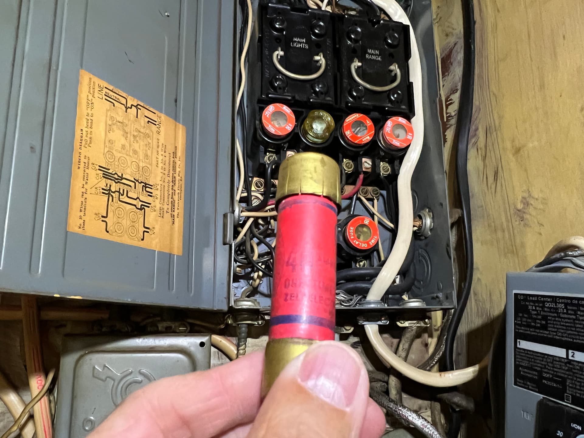

Lots of things going on here with fuses, plug fuses, breakers, and multiple subpanels.

In the 1950s, Wadsworth Bryant & Bulldog electrical panels were installed in residential and commercial buildings throughout the United States. Over time, some Wadsworth panels were found to be potentially problematic due to circuit breakers not tripping properly, which can pose a fire hazard.

Vintage/Obsolete/Split buss Wadsworth panel, Mr. Spence. Modern molded case single or double pole breakers, MCCBs, I hope I have the acronym right, do not fit were glass fusses are screwed in nor fit the upper split buss area for the Thumb fuses, Cartridge fuses referred to as cylindrical fuses with metallic caps at each end, known as ferrules, if I remember correctly.

And where do the put said Wadsworth molded case breakers Jeffrey. They don’t fit that panel.
I will refer you to my answer for Jeff Spence.
Nice looking fire hazard. That mess has handyman written all over it and needs immediate replacement. The sub-panel to the left is dangerously ungrounded and feed with parallel #12 AWG conductors.

From AL lighting circuit conductors, ungrounded equipment enclosure, to vintage/obsolete panels, and throw in a sparse bit of additional newer remote panel board enclosures and breakers to boot, it’s a wonder the home did not go up in flames or at the vary least cause enough erratic current, unstable or power fluctuations to have the home owner redo all the equipment.
Any-who… Some say a penny saved is a penny earned. :thinking:In this case, the penny saved could have lead to a house that burned.
