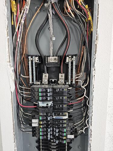

Warranty inspection today.
Who sees it?
Neutral/ground feeders tied together at the Subpanel, probably had to cut a lot of strands to get the ground to fit in the small lug. This also means none of the egcs on the grounding buses have a pathway to trip the breakers….yikes.
Soo…the receptacles in the house read open ground right? Or the receptacles show normal wiring and there is some other unintended bonding going on…yikesx2.
Gotta love new construction sometimes
Actually, they all tested normal, not sure why.
The only other bonding conductor is the solid copper at the left that goes to the gas line.
But yes, major safety hazard for the breakers. The grounds just dead end at this panel.
What’s funny is even if they did intend to wire this as a service panel, it’s still missing the bonding screw… so either way it would have been wrong.

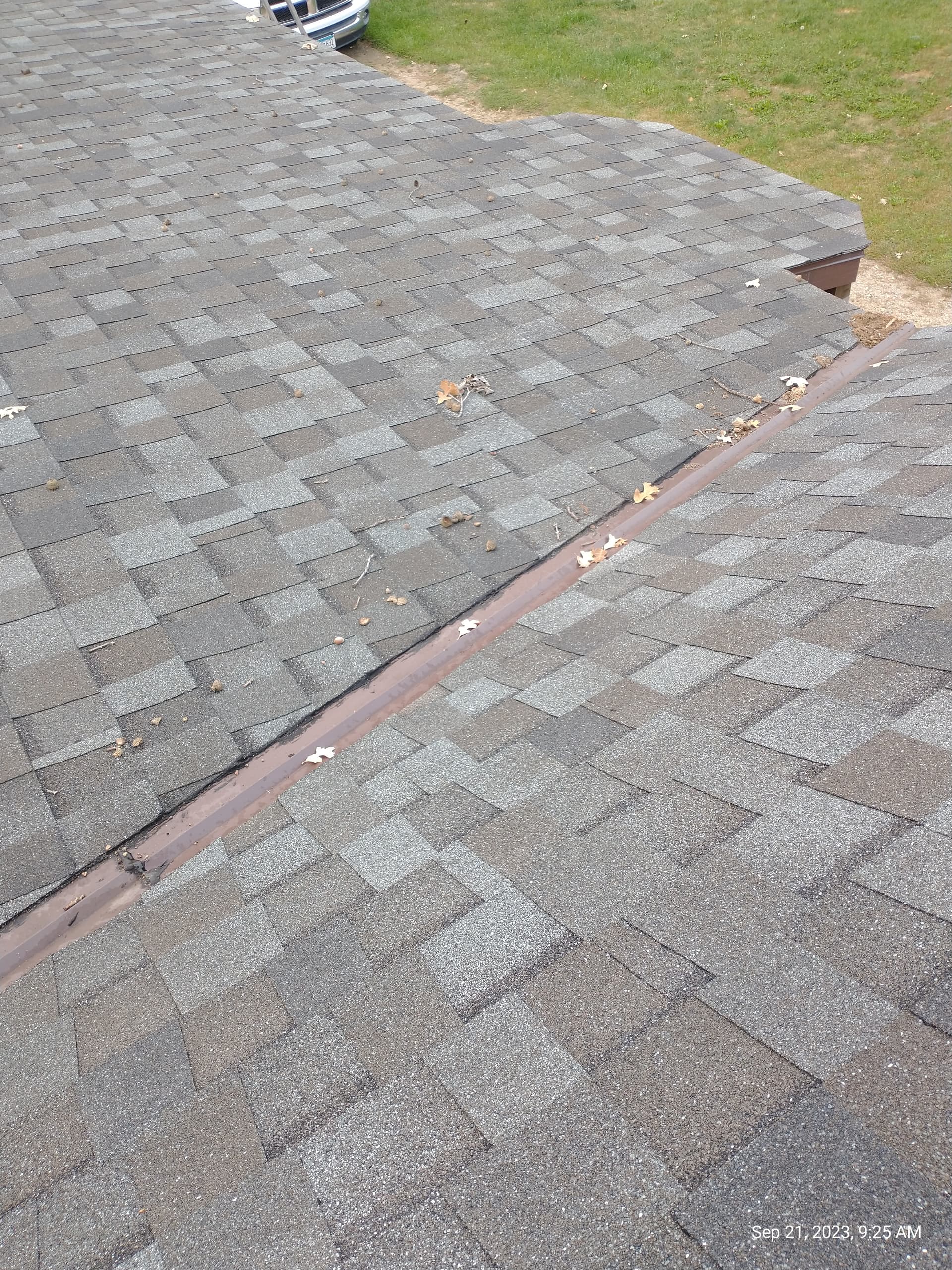

We have all seen this a 1000 times. Each time I think to myself, WTF!
But this time it appears someone removed the nail or predrilled it for a lag. SMH
Removed a nail or just did a pre-drill and never set a lag. :thinking: Either way it’s not right.
Edit, I see the “or” now!
Ah yes, a good bead of tar will keep this ill-advised valley arrangement from leaking.
Or not.
